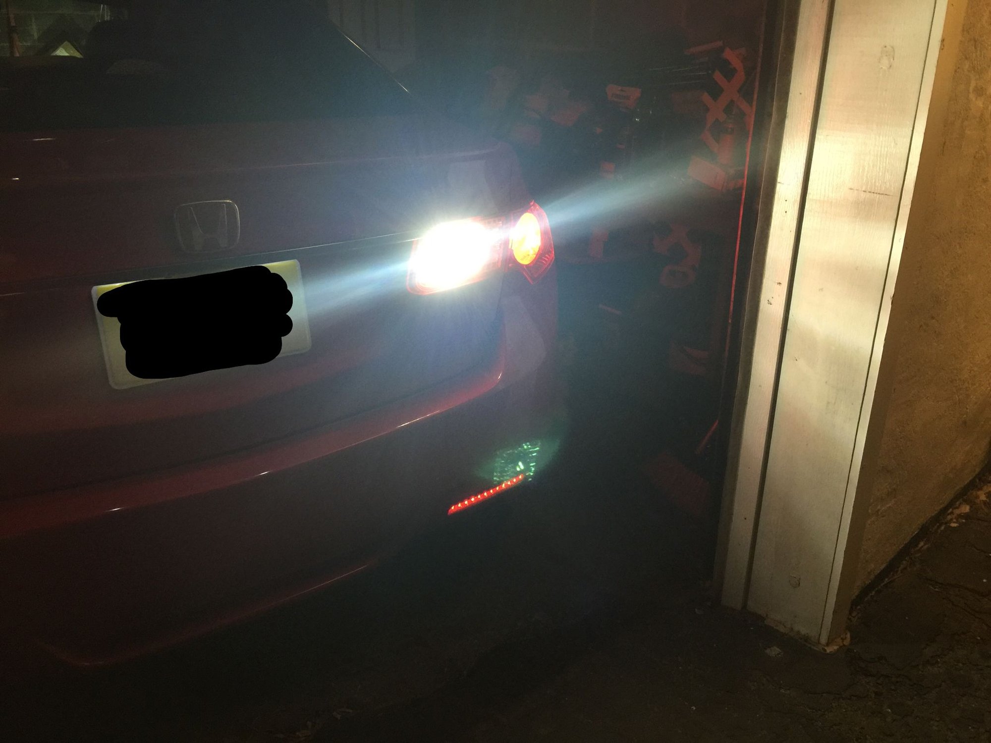

The camera was having a hard time picking up how bright this bulb is. Just one is brighter then two halogen and comes with warranty.

Are these hard to install? They are pricey but not having a back up camera with 20% tints is hard, so was looking into these. I assume they are just plug and play, and do i need to remove a lot of screws and what not to get into the housing?

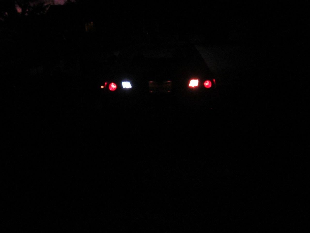

On the drivers side, two plastic snaps hold the trunk liner in place. On the passengers, only one, but its a bit tighter cuz something else is bolted down.
Bulbs pop in real easy. (Twist and pull out. Slide in, then twist to install)
Hardest part was getting the little plastic snaps back in place correct.
10 minutes total, including taking pictures of the brightness. Other pics of the garage door don't show any real difference, I was too far away. The brake lights are still brighter than the back up lights, but it is a help
New one on the Drivers Side

Yeah. Very easy to install.

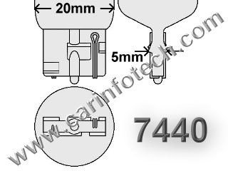

Probably not easily.
According to this lookup, the rear turn signal on the sedan is a 921. You can see if they'll physically fit, but I think the power draw is likely different between the 921 and 7440. Dimensions look obviously wrong:
921:
7440:

Thanks for this! Looks like I will need to go the vled route. It is either vleds, or several hundred dollars for a double din + back up camera set up.

No, 7440 won't fly unfortunately. :soory: I was speaking from my TL's experience where the bulb was a 921. I believe 921 draws more than 168 and 7440 draws more than 921, they are not compatible though.
