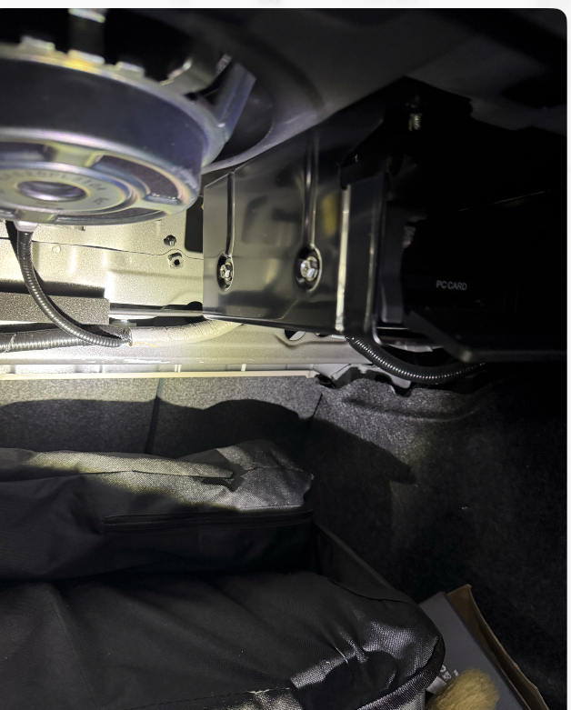

Old Feb 6, 2026 | 06:58 AM
Starksolo's Avatar
Joined: Feb 2026
Well for this, I simply took off the 4 bolts holding the DVD unit to the mounting bracket attached in the photo here. Then I reached in the back around the wiring connections and pushed the unit slightly forward towards me. I then got into the trunk and disconnected the wires one at a time (a little tricky but it got the job done). I could then pull it out. The other option is to remove trim at the back window inside the car and undo the bolts to the mounting bracket (black). I hope this helps.
OP, no need for all of that and this is what I did also. I folded the back seats down and accessed the wiring harnesses that way, as they were a little tough to remove since they were in place for so many years. I took the DVD unit apart and found that the whole spinning wheel assembly had fallen apart and was toast so I do not have Navi anymore. I don't miss it that much since in today's world it's pretty useless but the part that sucks is I learned the Navi is tied into many of the head unit's basic functionality and I can no longer change the colors, update the clock (which of course has the dreaded Honda problem so keeps going from 1-2 hours off), etc.
