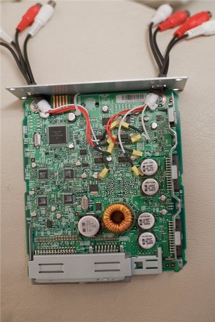

@mercman
Another question
Who can help me to find Line out on the board of the amplifier?
I have pictures with those was already done. But I cannot exactly recognize it.
I need the SUB and the Front Right/Left Signal at Line Out. Its 100% better as an L.O.C.. But i dont know how they take it at the Pictures.

You have ELS.
The audio adjustments take place in the factory amp not the HU, you can't use any signals from the HU.
The SW12 and MUTE signals are control signals not voltage sources, you can't use them to switch an amp on.
My Premium audio adapter uses a circuit and the hot always line to generate a 12 volt remote signal. My ELS preamp also had that circuit.
Put the covers back on your amp, tap the factory sub line, run a wire to the fuse box for remote and your good.

The Pictures are not from my amplifier
I dont need a Remote. personal
I need a LOW level input for my second ext. amplifier of the front boxes and the Subwoofer.
to see how in the Russian pictures it has already created somebody to measure directly on platine a signal. I thought they could help me. thanks.

While you can add RCAs to any amp it's not a good thing to do. In the case of the ELS one mistake and you out $1800 for a new amp. You will gain very little by doing this and you risk damage to your amp and ground loop issues. Not sure why you are having problems installing a LOC and tapping an ACC fuse.
Jeff

thanks for your statement.
I would like to connect directly Because would be cleaner signal and undistorted.
the amplifier is not so expensive. if 2 pieces have to lie here. both from polen for 20 €. and they work.
I have radio (HU) also twice. thus wass should happen. has even asked who can help me. where I would have to connect it.
with rest already manage I so far.

The last time I checked the factory ELS amp cost $1600 from the dealer. Not sure what amp you are referring to. Not sure why you think tapping into the signal before the PAL007 chips would yield an undistorted signal. At best you would only eliminate the Crossover distortion from the output chips which pales in comparison with the distortion that the A/D and D/A conversions introduce. Not to mention the crazy frequency shaping of the ELS DSP section. Your stuck with the DSP and the EQ because it is part of the ELS system. Without it you will have no control of the audio at all. Your doing a lot of work for basically no gain in SQ.
Jeff

Thanks for the information. the sound setting should already be possible to continue on the OEM radio. obviously that is probably nothing. I will continue to use my converter and is good. Thank you. I bought in Poland from aftermarket OEM amplifier. and in the German forums. of users who have their old expanded for new versions aftemarket

I saw your PM, I realy don't know what audio systems are in the non US market cars. In the US the ELS system has the door tweeter and front speaker on the same output. The Premium system has the tweeters run directly off the factory amp. What does it say on the actual radio, Premium of ELS? Do you have a 24 pin or 28 pin connector at the factory amp? Can you post some pictures of what you have? Car model Ids don't mean a thing to me.
Jeff

Hello
Here some Pictures
Thats my Second items where i can test something.
It's an 28 PIN Connector Amp. and an Premium Audio System Radio
At my car the Tweeter and front Door Speakers are connected AT the Same wires. The Tweeter has 6 Ohm and the door Speakers 2 Ohm. Thats Around about 1,5 Ohm for the Amp.
The door Speakers at the back had 2 Ohm at every Site.
The Sub at the right Side of the Trunk has 2 Ohm.
And i have Test it. On contact B3 from the Amp. are 12v switched by Key on ACC. So there i can Switch on my Second amp if i want. currently he is connected via the Hi / Low Converter. Thats The best.
28 PIN Connector at Amp.
Thats the HU

You have the ELS (digital) system, In the states the 2nd gen TSX (euro accord) came with a base audio system (Honda's have it and call it Premium) and the Tech package (ELS). There is no way to get a better signal from the ELS (digital) system, sorry. I did make a pre amp to replace the ELS amp but I have no plans to make anymore. I do make an adapter/harness for the base system but it will not work with your system.
So, in the states you have, Honda Standard, Honda Premium = (Acura TSX Base) and Acura ELS (Acura Premium) from 2009.
Jeff

Many thanks for your answer. I'll leave everything and continue to work with Hi / Low converters. My system runs yes. Either way or replacement of the complete HU. but I like the OEM style.

You need a wiring schematic from the output section off your OEM amp as the wiring is probably a different schematic going to the input section of your amp from your head unit. Yes I know it sounds ludicrous that they would stay consistent with wiring colors but they often don't.
