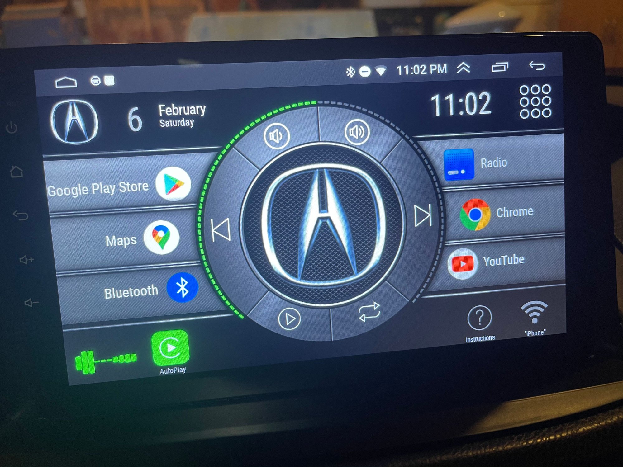

Well years of owning the tech package I figured it out and might as well get a certification in the electrical field.

Not sure if I missed details how you did this via a tablet. Please consider posting details. Looks very nice/smart way instead of trying to update old system take it to a tablet an use the latest greatest bells an whistles that can dumb down to old system. I'd like to do the same in a 2013 TSX wagon that has technology package

Intallation d'un Poste android 9" dans Accord Luxury (CHOGATH) ou autre ...
But in french !!!
