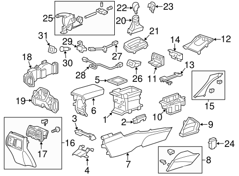

My bad likely doesn't help much, or at all. But #6 is the armrest. Maybe there's an issue with #3?

Here's an interactive one with more relevant parts:
CONSOLE for 2013 Acura TSX 5-DOOR
Maybe you can try tightening the bolts you see there.
