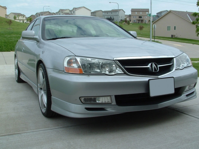

Your wheels might stick out some.
I have 8" wide wheels with a +45 and that got me the flush look I wanted, I think any thing less will stick out.
