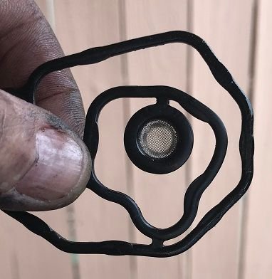

So in I go again to clean the screens, change the trans filter and start the 3x3.
The dual linear solenoid was clean (the one on top). The single (on the front), not so much. Here's the before and after pic of the screen.

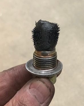

Then pull the drain plug to start the 3x3. Doesn't look good. I did this just over a year ago. Fluid looks and smelled OK. I'll get to the rest of the 3x3 in the next week or two after I've logged a few more miles.
So after the first drain/fill, there's not much difference. However, the last time I went though this, it didn't improve until the 2nd cycle. Hopefully, it will improve once I complete the entire cycle.

The TL has been sitting for the past 2 weeks while I used my old XJ. I only did 2 of the 3 drain/fill. The drain plug had a little bit on it about 20-30 miles after #1. I don't think I've driven it more than about the same amount since #2. While running some errands with the TL today I simply didn't notice the slip so I found a stretch of road where I could hammer down. In both D5 and in "manual mode" the 3-4 shift was clean, swift and solid. The others were as well.
Perhaps some debris block a passage or two and restricted the flow to 4th and driving it enough finally cleared it out?
