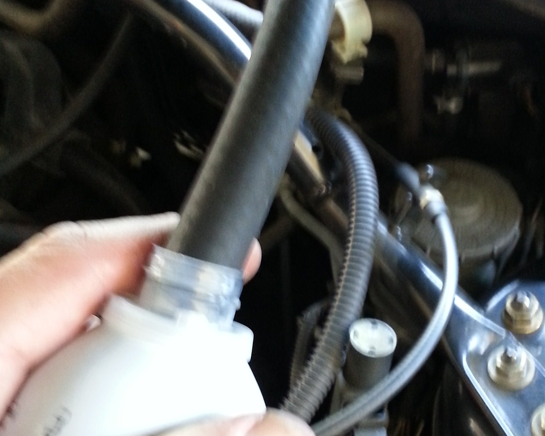

'Tried Sea Foam the first time today on my '03 CL-S with 174K miles. My reason was to rid engine hesitation.
I used the large brake booster vacuum line to have it sucked into, though oddly I did not find the line right away since it is large in diameter. I attached some photos to help:
1) identifying the engine shroud mounting bolts (4), each 10mm
2) shroud removed exposing the manifold
3) the brake booster vacuum line connection location at the back of the intake manifold (the side nearest the firewall, a little toward the driver's side)
4) Sea Foam being sucked in
I used a 12 oz can of Sea Foam through a 2 foot length of 1/2" diameter heater hose. I slipped one end over the manifold fitting and the other slipped into can the opening without direct contact with the liquid. The heater hose was a little loose at the manifold but okay since this vacuum line is strong. I allowed the vacuum to suck in the solution for ~5-10 second intervals with a pause when the engine started to stumble until 1/2 of the can was emptied. This took near two minutes. Then shut of the engine and waited 7-10 minutes (not more than 15). During the wait time I re-connected the vacuum line from the brake booster at the manifold, snipping about 3/8" off the end of the vacuum line for a fresher fit connection to the manifold fitting. Then screwed the shroud back on. All in about 8 minutes. Then cranked the engine over with a few soft pulses on the gas pedal and it started a little rough, then smoothed out. Immediately I drove away until the engine was running completely smooth then slammed on the gas and whoof, a thick cloud of white smoke was left behind standing still in the air (your first hop is best not done in your neighborhood). Accelerated until the VTEC valve timing engaged (high RPM under load) a couple more times then opened it up on an uphill freeway on-ramp. The smoke was gone by then and the engine running a tad bit smoother. Accelerating hard heats up the combustion chamber and related areas to help dispel dissolved gunk the Sea Foam loosened.

STOP DO NOT USE THIS VAC PORT FROM BRAKE BOOSTER!!!!!!!!!!
it only feeds seafoam to the rear 3 cylinders! which is a reallllly bad thing
immediately correct this- at MASTER vac port- that hose clamped to TB inlet to manifold
pulls 20 inches vac at idle- makes tornado of seafoam

but NEVER use brake booster on the TL

Okay, makes sense where to connect the vacuum line (though some SeaFoam would make its way to other cylinders in pulsing). 2 questions then:
1) do you know how to modify or delete a post?
2) do you have pics showing everyone where the master vacuum line is as you mention?
