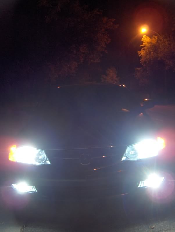

Took a couple quick (poor quality) shots. I apologize for the quality as I didn't have a tripod set up. It's hard to get a good feel for what they look like because of the glare, but you can get an idea.

Yup as you said man, i mean you can definately tell that the driver side isnt hid, i mean might be the owner who sold you this car burnt the hid or the ballast or take them away to resell it lol.
If your familiar with taking off the bumper, and those housin lights, you could definately check and see if the ballasts are stil there. If they still there, switch the bulb to see if the ballast isnt fried, and if they work perfectly then all you need is a new oem hid bulb or a after market bulb
Anyway the bulb type is HID-D2R.

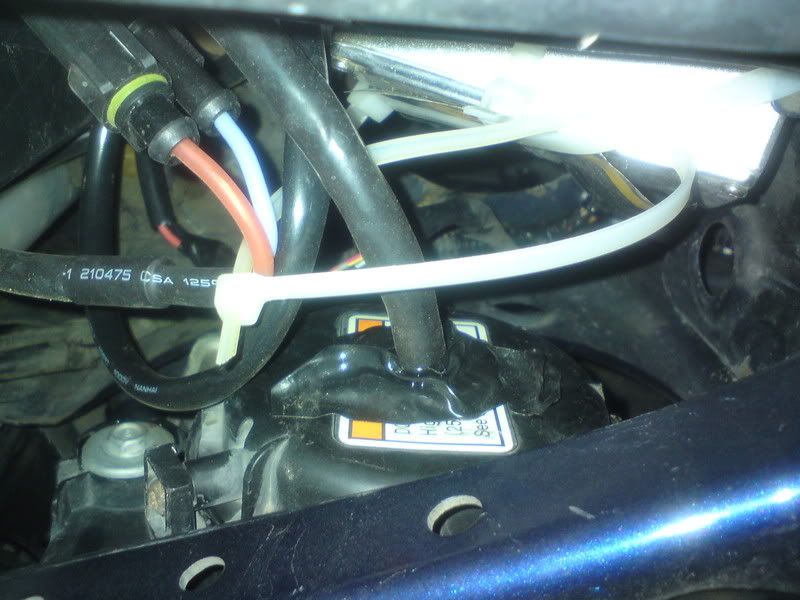

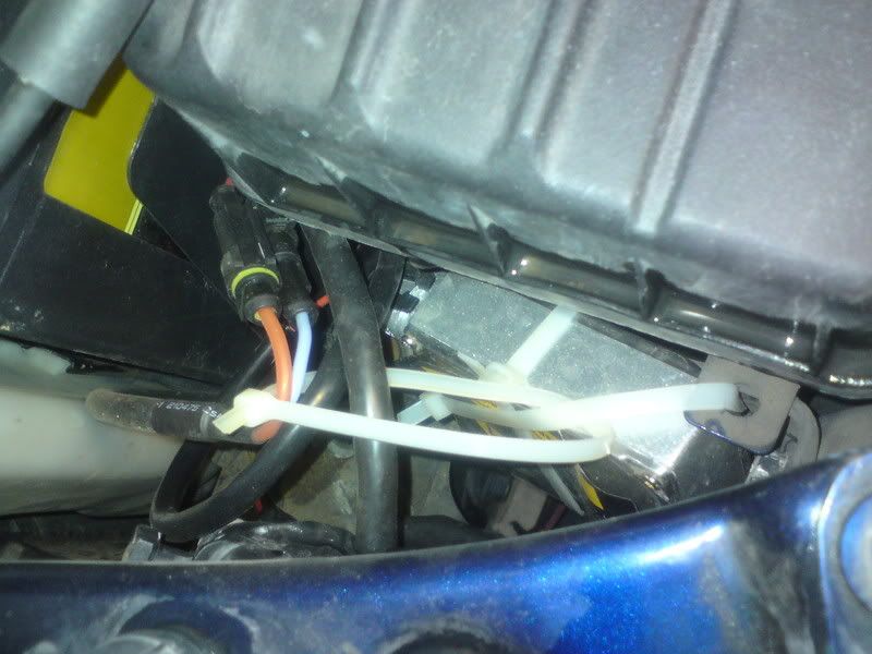

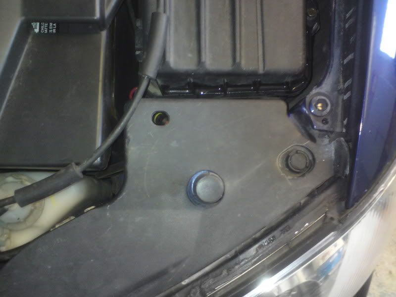

Okay so I did a bit more investigating tonight after work. I pulled the battery out, moved the coolant reservoir, and took that little vent elbow off so I could get access to the back of the d. side headlight. The first thing I noticed were wire splices on the two wires coming off the bulb. Not a good sign. I pop the cover off the back of where the bulb is mounted and pop the bulb out. Definitely not a D2R but actually a 9005 halogen! I am guessing someone brought the car to a bubba mechanic to 'fix the broken headlight' and this was their (not so bright...literally) solution. There was no sign of a ballast or ignitor. I checked the p. side quickly (what a pain) and it definitely had the ballast and ignitor behind the cover. Luckily they didn't splice into the actual wiring harness but just the bulb wiring itself. It looks like I am going to need one ballast/ignitor setup for the d. side and bulb at the very least. Would I be better off picking up oem stuff via ebay or should I just get an aftermarket 4500/5000k kit to replace it all? I have pics I will post later...I am posting from my cell right now.

Okay I got a chance to upload the photos I took. My main question is... should I bother getting a (used) OEM ballast/ignitor via eBay and then buying a pair of bulbs... or should I just get an aftermarket kit and replace both sides? On to the pictures...
The first thing I see... hmm this isn't good.
Digging deeper and deeper...
High beam... this looks fine as far as I can tell.
But yet what is this?
Hmm this sure doesn't look like a D2R HID bulb..
Oh that's right... it's a 9005! How stupid, I should have known.
This is the passenger's side with the correct parts..
One other question - is the ballast part (the cylindrical part I believe it is) attached to the actual bulb, or does it just sit against it? My passenger side one was pretty crammed in there so it was hard to tell. Thank you

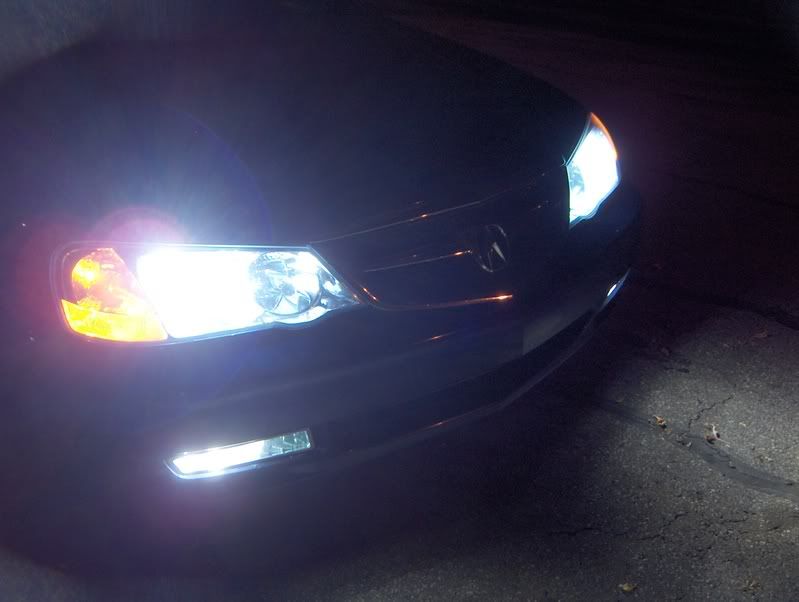

Since it was quite cheap, I simply went with an ebay d2r hid kit for 110 bucks shipped. I ordered it with 6K bulbs and have had 0 problems so far. The only part that wasn't simple was the install, simply because I had to cut off the stock plug that gives the ballast power and couple the wires to the aftermarket ballast's wires. I decided to leave the stock ballast in place to keep the headlight sealed underneath, so I had to drill a hole in the back of the bulb's casing to run the wires. I used a grommet to shrink the hole and then sealed it all up. It's not the prettiest setup, but it's all hidden under that plastic part and it all works fantastic. I just hope it holds up in the freezing cold temps up here.

Been cleaned...nice and dirty there
