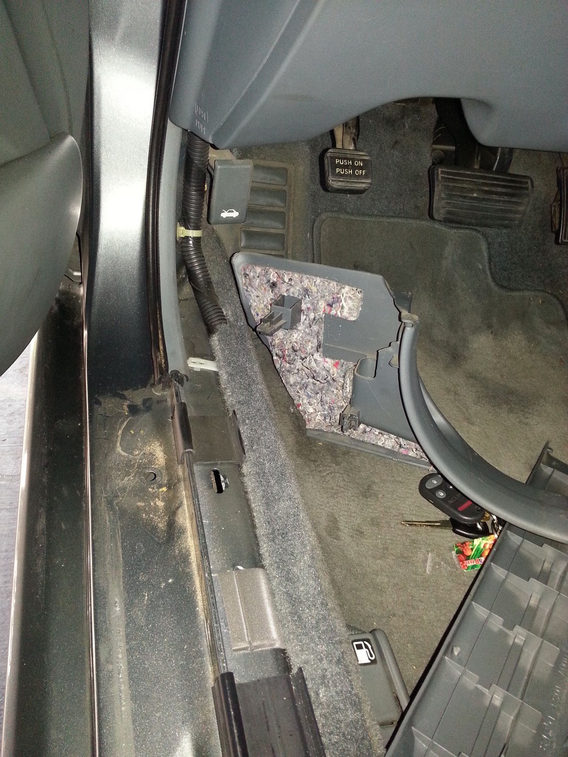

The cable runs from the kick panel through the left door hinge area out in between the fender and the apron, then under the left side of the radiator tie bar to the hood latch.
This is what I would do.
Remove the left head lamp, hood latch plastic cover, left fender splash shield (it may help to lift car off the ground and let the wheel hang for clearance). With safety in mind.
Note: remove the cable last. You will use the cable as a fishing wire.
Remove the latch bolts... mark the latch position by scribing or marker pen on the bolt washer to the mounting bracket or mark the latch it self.
To unhook the cable from the latch... just pull up on the cable to release the white nipple and then unhook the cable. When installing the cable be careful not to use too much force when attaching the white nipple to the latch, it can break, so use as little force as possible.
Inside the car... Unbolt the handle. Cut the cable at the handle, leaving as much cable as possible. Now use painters masking tape and tape the old cable to the new cable (white nipple end/latch end) and fish it through the hinge pillar area by pushing and pulling on the cables to fish it through the hinge pillar area. Be sure to lube the cables with Vaseline to help it slip through the grommet.
Once through the grommet and inside the fender area just follow the old cable route.
Once new cable is in place, mount the handle and the latch (use your markings to position the latch).
Test the hood release by using the screw driver method as mentioned before. For insurance you might want to remove the hood grill so you have access to the latch if things don't go as plan (for releasing the latch).
If the latch releases as normal, then close the hood as final test.
To adjust for fit: you can use the latch mounting bolts... up/down/side to side. As a last resort you can bend the hood striker a little to move the hood side to side by hitting it with a plastic mallet.
When your satisfied with the alignment of the hood, just reverse removal instructions to install.
Good Luck.

Oh, I didn't realize that the cable unhooks at handle side too... see pic.
