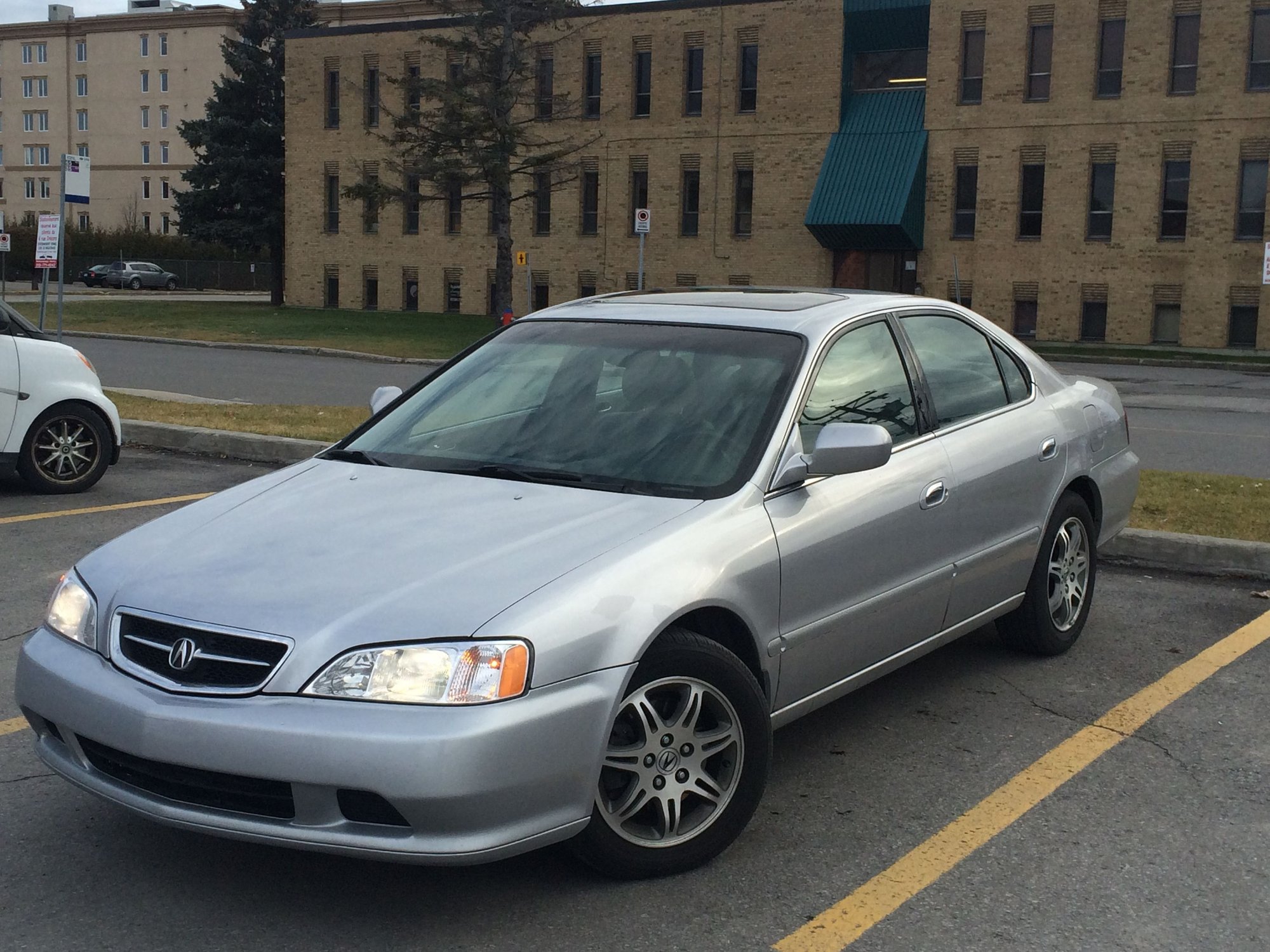

Heres a picture! Car has always been in garage and rust proofed for 10years!

Looks good! Were you able to swap the lights?
