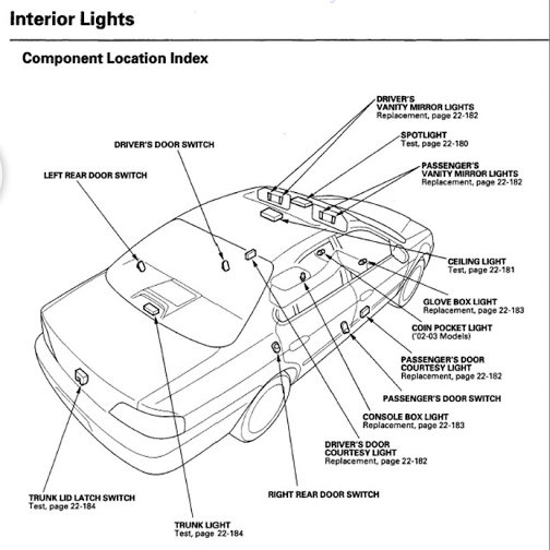

Where is the Acc panel/circuit located? What is on that circuit?
It could be the Blend Door motor stuck on. There is precedence. Mind as well check the Mode motor too while you're at it. Will only take a few minutes. Just disconnect the connector at the motor (one at a time).
Both motors are on the left and right sides of the center console under the dash. Look for two black boxes just a little smaller than a deck of cards.
Also check the activation switches on all the interior lights, could be stuck on.

Location of switches and lights
