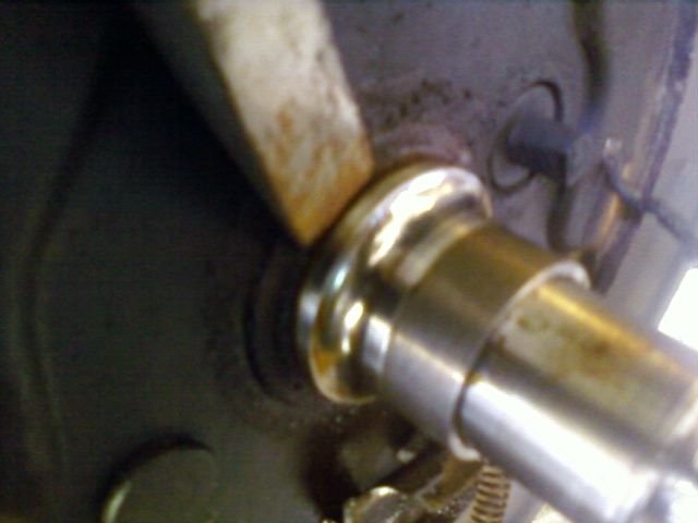

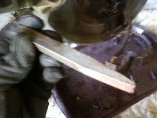

? i pulled the hub off, replaced the bearing put it back on. Only issue i had was the outer bearing race was stuck to the shaft. Took a little chisel to the back of it to get it started and it slid right off and the new one went on. Im wondering if that is his issue (as i have seen others with it) and why i asked for pics.

It's pretty common for half of the inner race to stick to the hub/flange. It is a press fit on the front, so this is normal. I usually cut a small groove in the race with a torch, and chisel it off.

^ Indeed I did mine about a year ago.. Both front wheel races sticked to the shaft. But I used a circular saw to grind a side carefully until they snap* once you hear that distinctive noise you know they will slide off easily.
