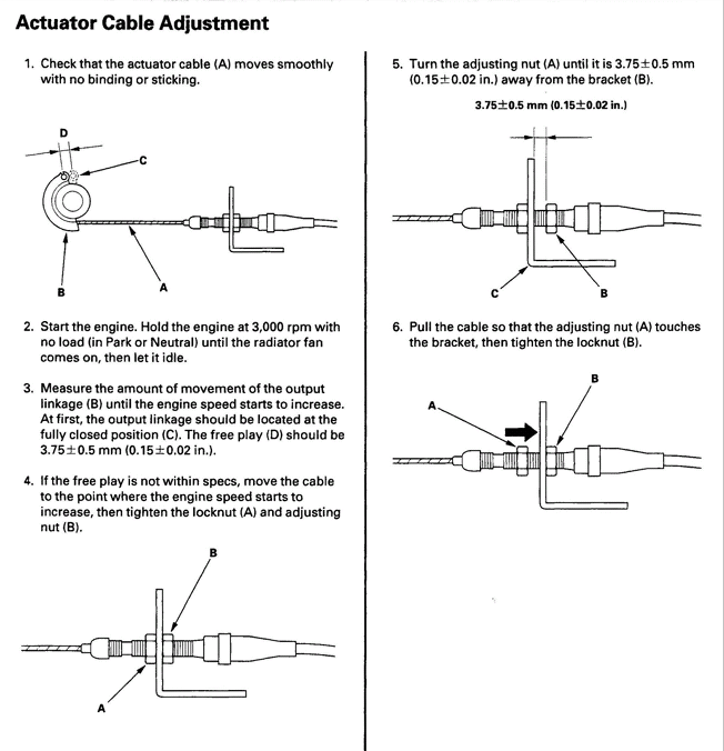

I was hoping no adjustment would be necessary; but if it is, thank-you for this.
What I plan to do is replace the part labeled "B" in your diagram (top-left corner). This part is on a shaft with a whole bunch of other parts some of which are spring-loaded. I was hoping for detailed instructions on how to remove the parts from the shaft and put them back properly so I can replace my broken "part B".

There's nothing on that part B over haul. They're service as a unit.

Again, thanks for the info on the cruise control unit; but it is the plastic disk where the other end of the cruise control cable connects to that I need to replace. If you look at figure 1 in your most recent post you can see where the two cables (one from the cruise control unit and the regular throttle cable) connect to the engine's throttle body. That is the section I would like to take apart. I was able to do it easily to get the good part off the wreck, but I'm not sure I have the confidence to replace it properly on my car. I'm starting to think Acura does not want that assembly(like the seat-belt) serviced.
