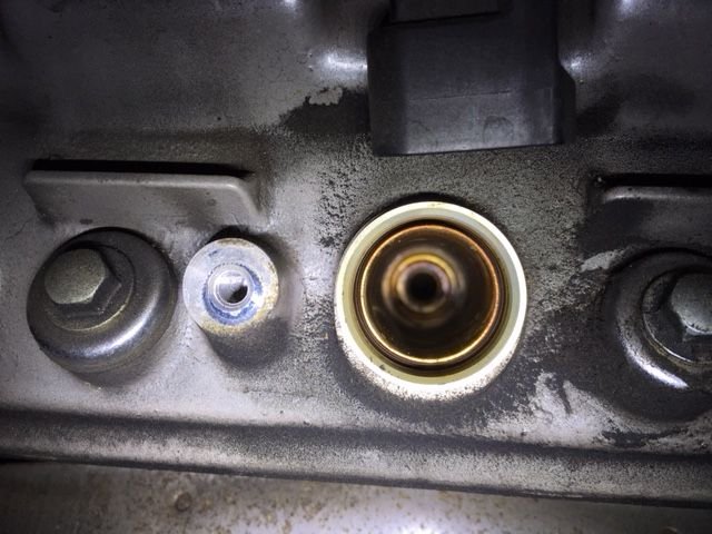

I was only able to get a look down the plug wells on the front side of the engine. This is plug well number "5".
number "5" spark plug well, dirty. number 4 plug well looks nice and clean! =) number 6 is the same.

Couple of questions: Which car do you have? Are the pictured plugs, the PZFR5F-11 Ngks)? Are these the recommended plug , for your model? Any idea, how many miles, on these plugs? How many miles on the car. Plug well # 5 appears to have a seal issue, easily fixable, replace them all. Correct torque, when installing the plugs, is critical. It insures that the spark plug "washer", is crushed properly, creating a tight seal. Any debris, at the plug seating area, on the head, can also create problems, resulting in leaks. As a side note, are you using a "TOP TIER" fuel?

Hey tad2much, Thanks for your reply. Still curious, how many miles on the car, and if you are using a (TOP TIER) fuel. If not, you may want to consider it. It's difficult to tell from the pics., but those plugs appear to have had significant use. Checking the gap, should confirm this. As long as there is no "pooling" of oil, in the spark plug wells, and the rocker arm cover gasket is not leaking, you should be good. In the event you want to replace the rocker arm cover, and spark plug well gaskets, and seals, there is a (HOW TO), which is described, in the initial steps, involved in the valve adjustment procedure. You may also want to check the valve adjustment, while your in there.

Spark plug T seal defective... $3 ea.
PN: 12342-RYE-004

From your pics above your #5 T (tube) is saturated with oil due to the T seal leaking as oppose to #4 T... Being clean. Also from your pics of the 6 spark plugs, some of them shows oil saturated on the plug's threads/body. Which indicates oil leaking from the T seals.
Likewise, the plugs them selves are firing normal or more accurately the burn patterns are all normal. Which means there is no excess oil leaking into the combustion chamber. Just normal amounts of oil being burn in the combustion chamber. That would explain for some of your oil consumption.
Yes, you have to take the valve covers off to change the T seals. If you're going to change the T seals then you should change all the seals and gaskets on the valve covers to prevent leaks from recycled gaskets/seals.
