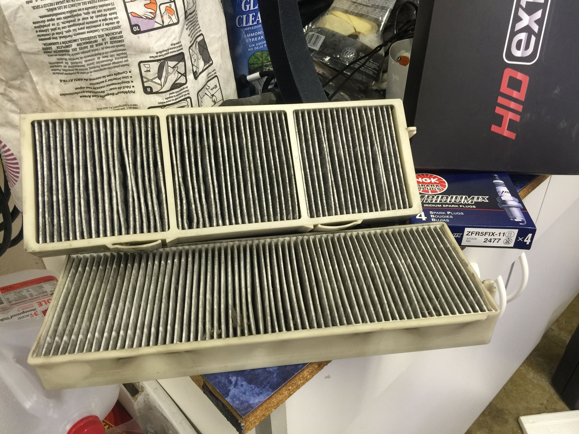

Alright so if anyone is still interested here I took a little break from fixing this issue due to more important issues with the starter I have now fixed it and I'm back on the road so im picking up where I left off, first thing first I decided the cabin air filter might be a good idea to replace while I'm here and this is what I found
Wonder if maybe this is part of the problem

While it appears as though the cabin filters were indeed due for changing, I'd doubt that they were causing your previous problems. You'll know once ya put them in !!!

use a shop vac to get everything possible out of the filter inlet tube and general area
spiders, birds nest- you would be amazed at some of the pics posted on here
Did you pressure test the cooling system yet? hose clamps loosen over time or replaced and not set right,,, I have even seen OE style rad hose clamps break in half,plop

Ok so I replaced the cabin air filter and it still isn't working kinda weird that I can feel the heat coming out of the vents just not a whole lot, and I noticed earlier today a little click and whining sound coming from under my glove box every time I would hit the ac on switch. Those cabin air filters appear to never have been changed lol I really thought maybe they were that bad unfortunately this car hasnt really been maitnenced much I don't think and part of that is why I bouhgt it cause it only has 130,xxx miles however some stuff I'm finding hasn't been done is unbelievable. No I havnt pressure tested it yet Just because I got distracted on the starter problem until I fixed it yesterday and also a power steering issue lol but I think I might have time tonight before I leave work maybe pull it out and see what I got going on here. Also I didn't vacuum the inlet tube tonight I will go back and do that maybe something is caught in it

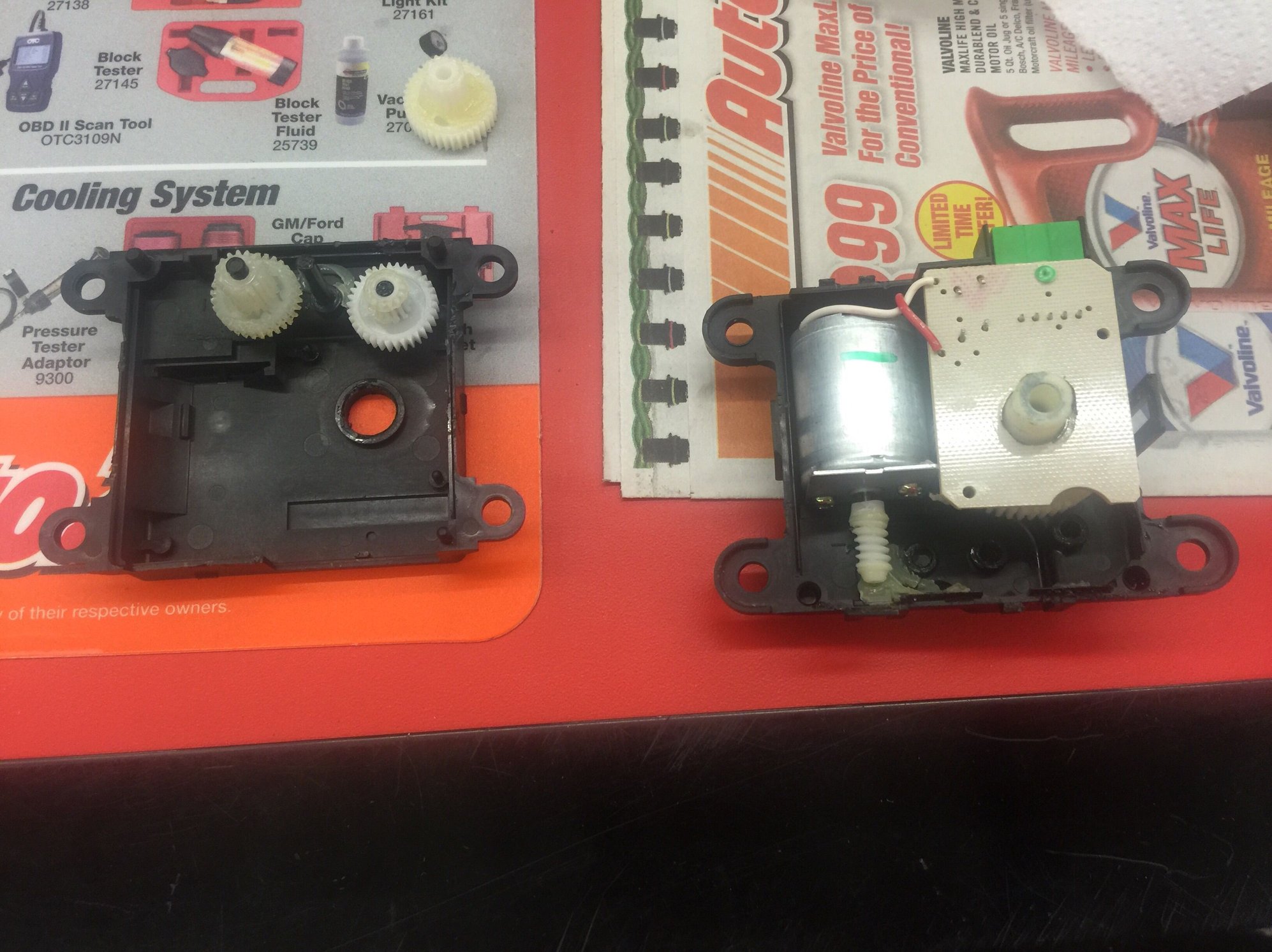

Wink Air mix motor.......
Originally Posted by OlyUA4
Shortly after summer ended I realized my heater wasn't working and that only the air conditioning was working, and everytime I tried to put the heater on I would hear a clicking for about 30 seconds.
I came on this site and did some reading and found a few threads talking about the valve behind the engine that needs to be sprayed with a little wd-40 and cleaned up so it sounded easy enough I went to the garage did it and wolah the heater began working again.
However I did notice the clicking stopped happening when I put heat on and started happening when I put the ac on but it still worked. It worked for about two weeks and in that time I noticed there was no in between on my system even if I had it set to 70 degrees inside it was either hot or cold...
But it worked and that was what mattered until a couple days ago I while driving I tried to put the heat on and nothing happened.
Hey OlyUA4, if everything else seems to check out.....go back through what ya tried earlier and try it again.
Seems like ya might've been on to something, IMO. Check out Skirmich's DIY fix for the air mix motor !!!
Hey I seen his diy for the air mix motor and I was curious about that. It sure sounds like that could be myproblem. ill check it today

Ok so I got the air mix controller out of my car today just popped it off when a couple wheels fell out, I just realized on the inside mine looks much different than the one used on the diy and I'm lost has anyone done this on a 99 model? Here's a picture of what I found

Any ziners out there who can help me fix this problem now? Think I messed up pretty bad waiting some help of either how to put this air mix motor back together, or where to buy a new one.

Check an online Acura parts source or local dealership for more details and pricing on a new part.
Ya may wanna check with your local salvage yard for a similar '99 used part.
