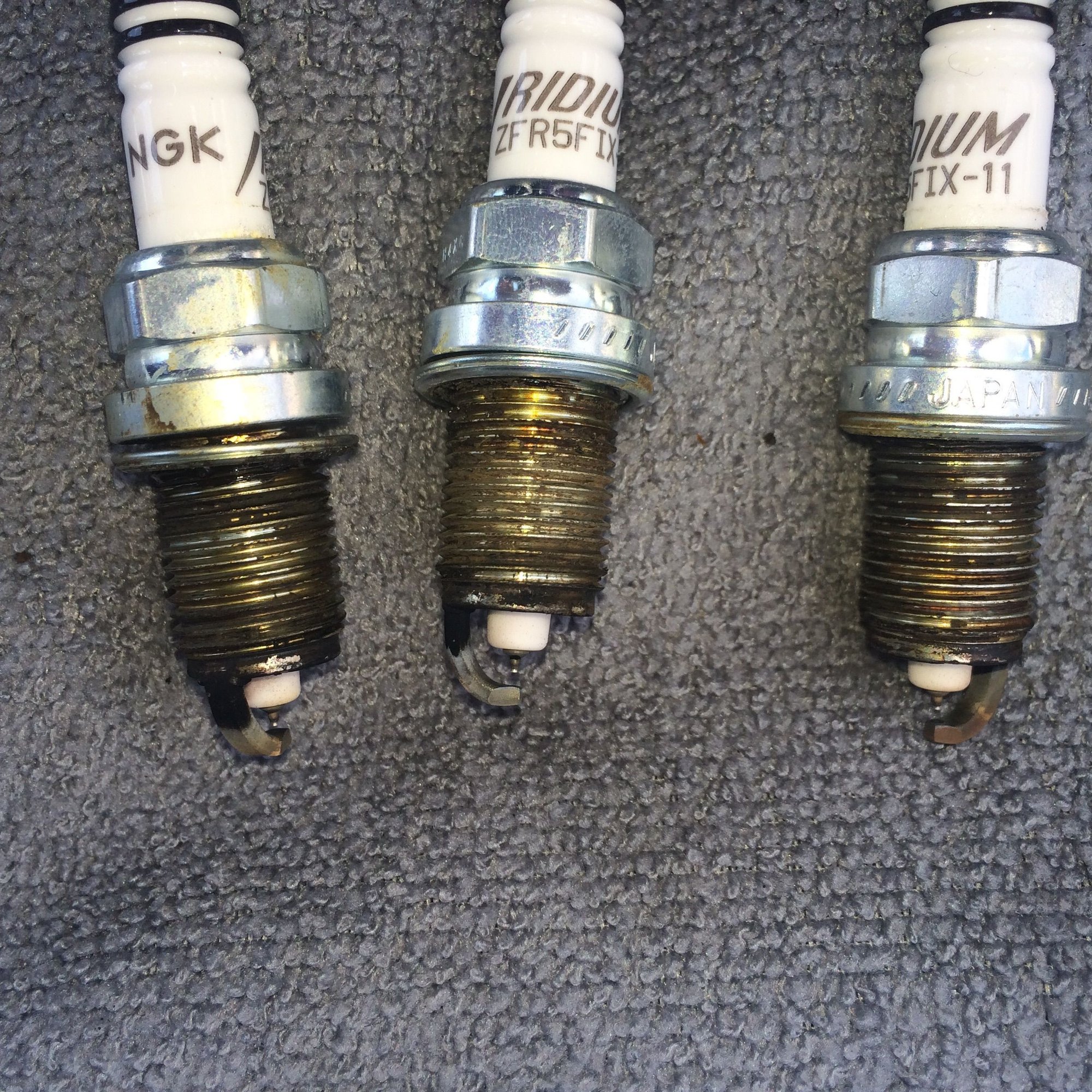

Ok first I did a cool pack check from a video on YouTube and found out my cool packs are good also I have iridium ngk spark plugs a friend that works at oreilys helps me buy my car stuff also my uncle said the spark plugs my have some dirt on them and that's why they are misfiring so if I clean them would that make them run normal?

how did dirt get on your new plugs? were they dropped on the ground?
at that point you can figure the gap is no longer correct!

No they were not dropped but inside the holes there was already dirt inside from the previous ngk and owner who didn't do a good job maintaining the car

Old Apr 22, 2015 | 04:17 PM
01tl4tl's Avatar
Posts: 33,535
Likes: 1,142
the dirt is normal and if you installed the plugs straight down without banging them around = all is well
any minor dirt will burn off
You can use Seafoam fuel cleaner at 1 can to half tank of gas to clean the entire system including plugs, its real tune up in a can for us! 2 cans for $16 at oreillys right now
note - your plug color looks very good- engine is running well!

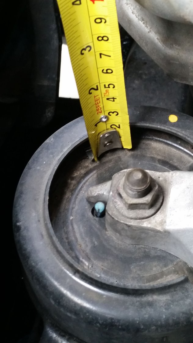

@01tl4tl I'm not sure how to tell if the mounts are failed but I do not have a vacuum leak (idle rpm seems fine, no hissing noises). The engine does move a fair amount (maybe .5") if starting from a stop on a steep incline and I've noticed a metal-on-metal click/snap when shifting into reverse from park with the brakes on.
Here's an image of my front:
I plan to do most of the labor myself, except for the bearings and the timing belt/water pump.

look at the front mount from underneath, a few drops of oil on it or on the ground below it.
Mount looks swollen and collapsed when failed
