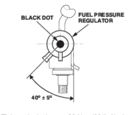

FPR
Disconnect the battery before working on the FPR. You will need the radio code.
^How the FPR should be after it's installed.
See the link below.
https://acurazine.com/forums/problem...ura-tl-941112/
