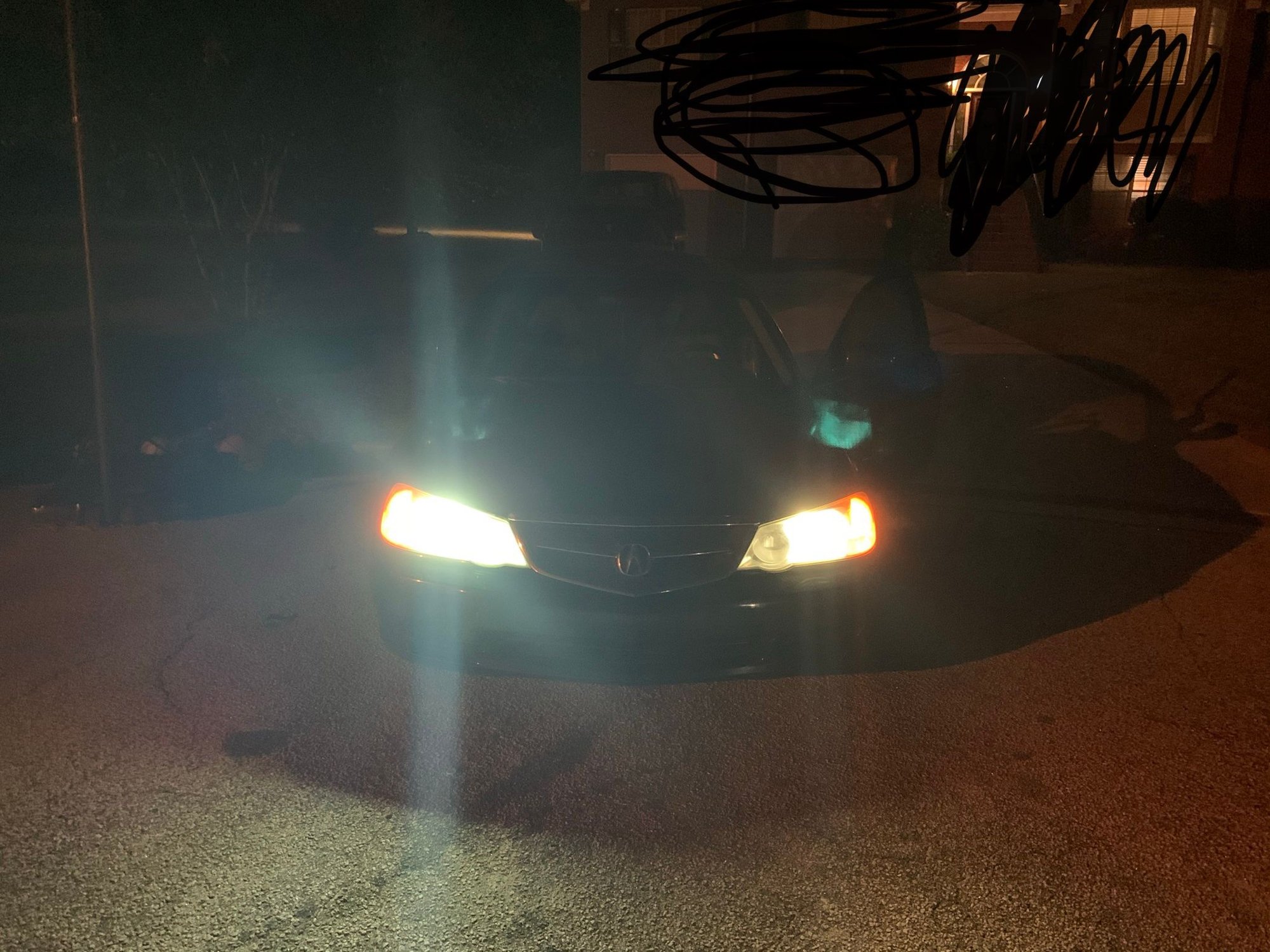

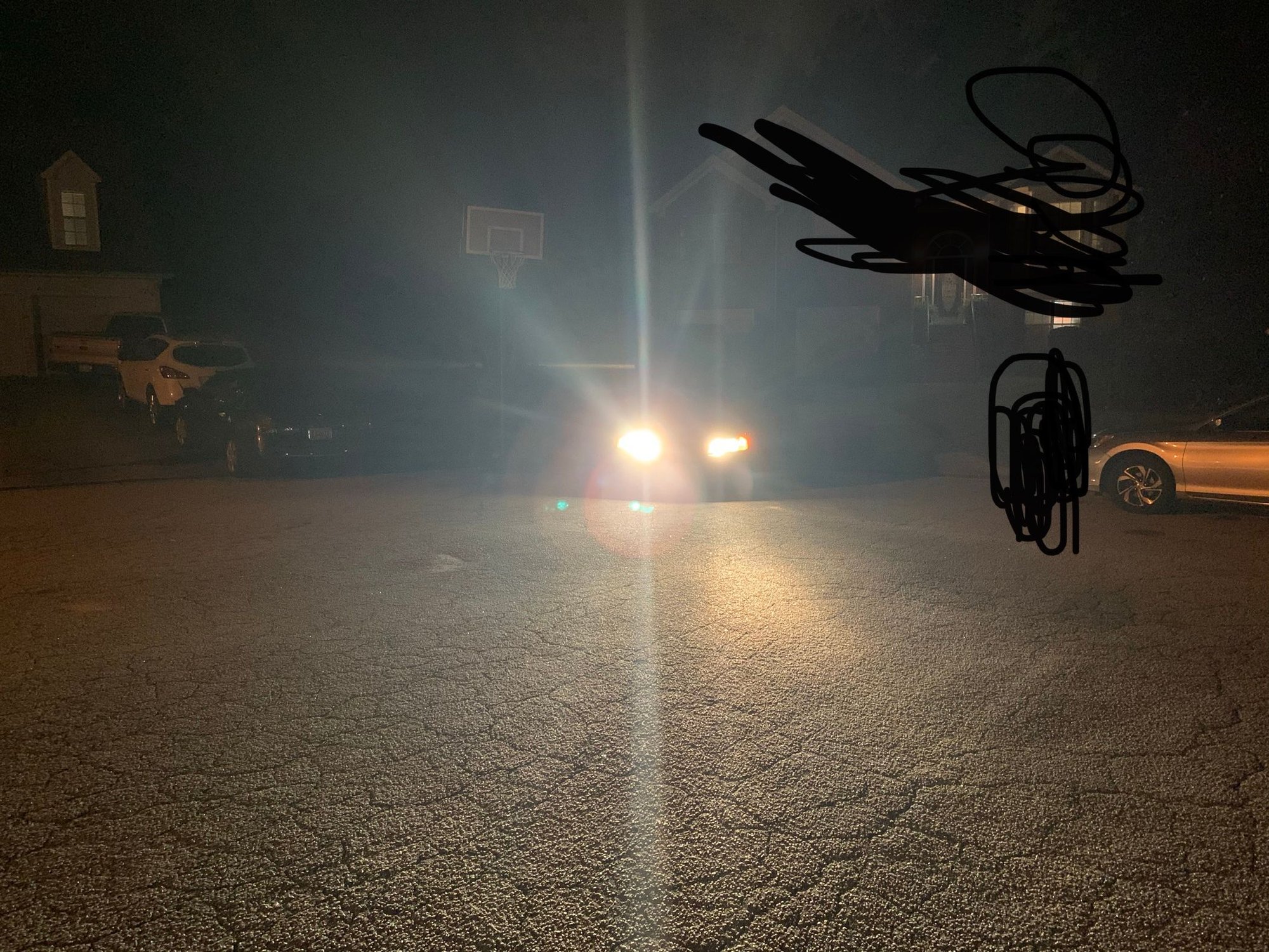

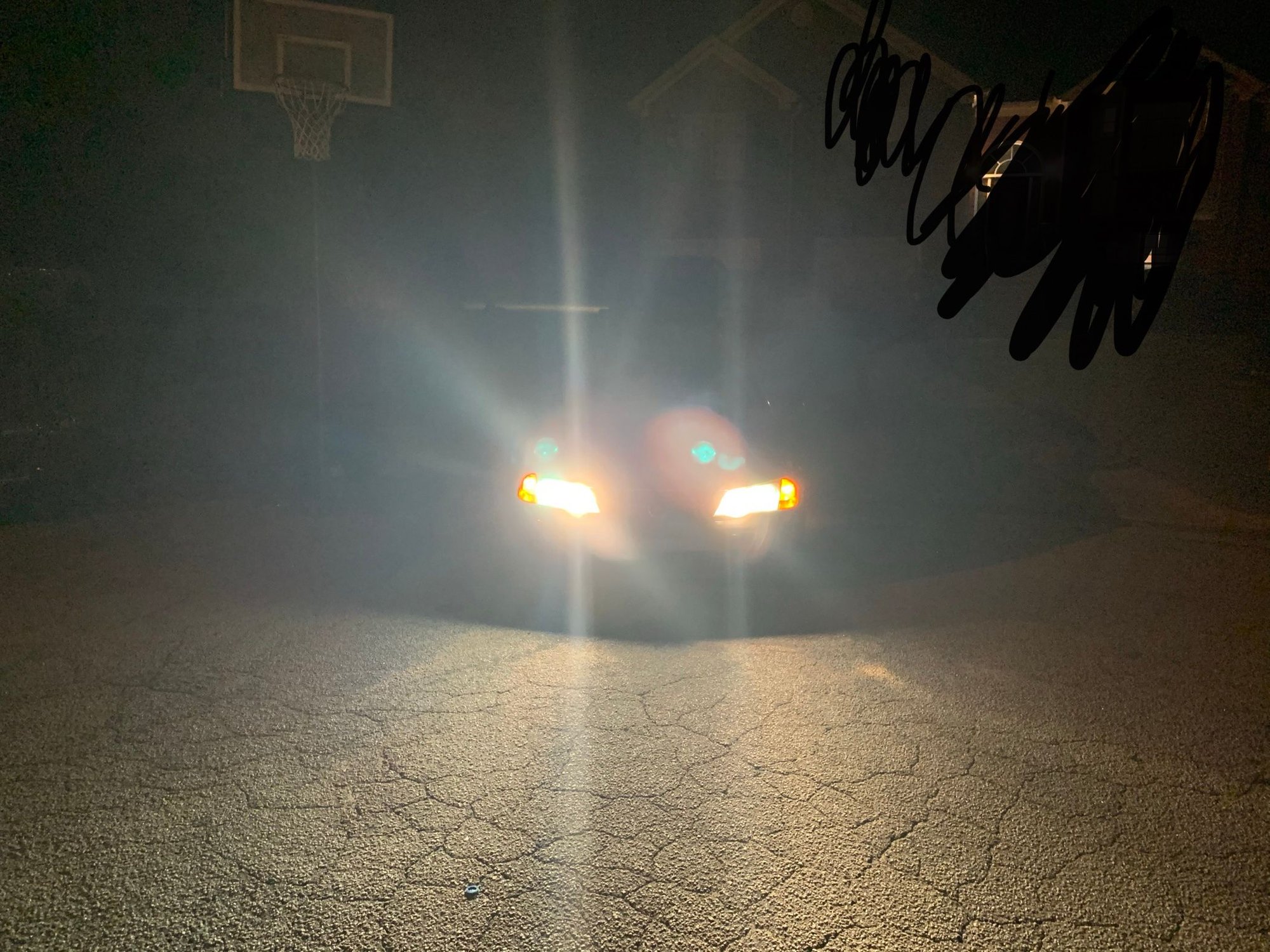

Low beams far 20-30 ft away
Low beams close 5-10ft away Take notice of the driver side bulb not doing well
High Beams Far30-40 feet away Take notice at how the passenger bulb is bright enough to ignite a glare in the camera unlike the driver side bulb, yet the driver side bulb is the one you see more in the road. The confusion this brings me is beyond me
High Beams Close about 10ftv away

pics of a wall from 10-30 feet away please. Pics of the headlights directly at us do no good
