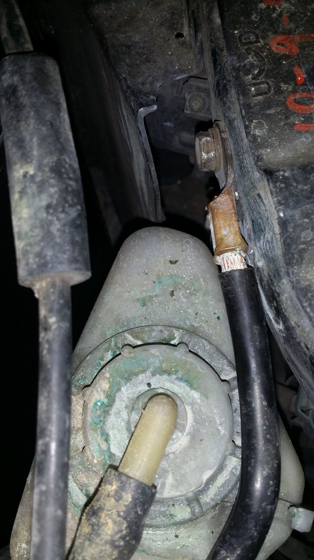

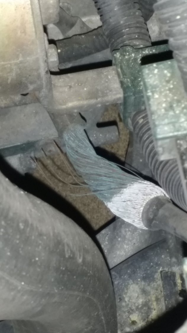

The third pic is a grounding cable. It's normal to be bare.
Your cables are in bad shape. Remove them from the car and soak them in a baking soda and water solution (15% baking soda) and scub them with a wire brush or replace them with new. Also clean the mounting points on the car side. Buy a battery terminal cleaner ($5) and clean the cable's area where it mounts to the battery posts... You want fresh metal showing.
