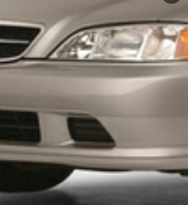

I'm looking at the shape and size. The Rock Auto options seem way longer than the opening.

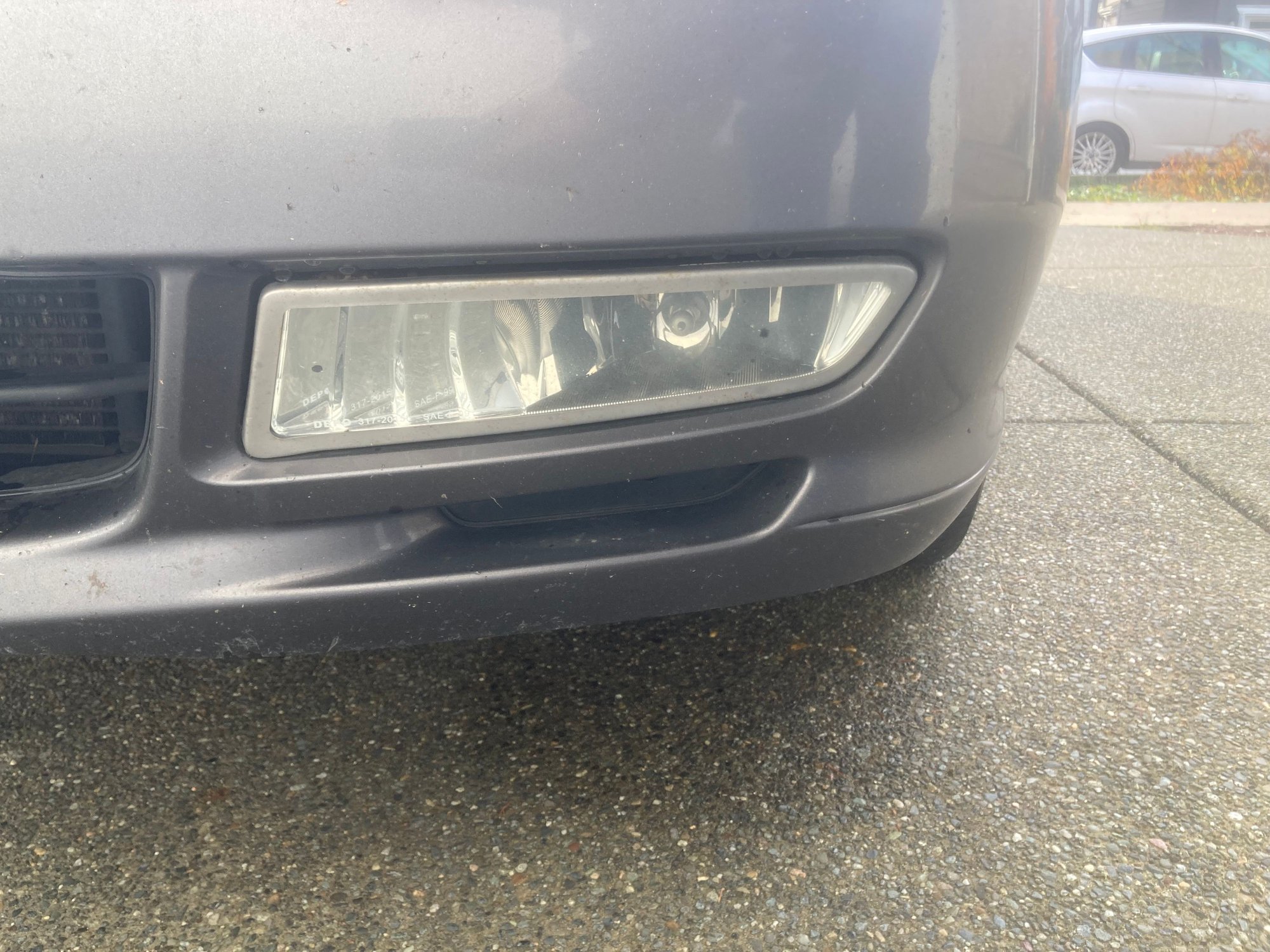

Both TYC and the DEPO brands shown fit. If you need bulbs too, the DEPO ones come with bulbs fwiw. They make nice daytime lights when you rewire the switch on the dash

Well that's surprising. I should look up the dimensions. My opening is about 5" wide at the top and about 7" at the bottom. About 5" tall.
These look wider and thinner.

These fit my 03 TL-S just fine

That's the wrinkle. I'm looking at pic of the 2003. The opening on the 2001 is closer to a square than a rectangle. I also learned this year did not originally have fog lights. Some suggestion that an inspire ser may fit.

Well, ok, that is clearer info now (2001, base model). The bumper cover is different. You could change the cover to allow for the lights on RA, or find some to fit. Since it didn’t come with lights there, you’ll need wiring too. Can I suggest a walk through your fav local junkyard? Look for a TL with the lights to get the harnesses, and dash switch, and measure up other car lights to what fits best for your base ‘01?
