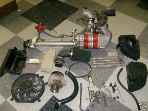

hello,
I have a 03 TL-P and , just won a ebay bidding for "2001 Accord v6 Comptech Supercharger".
My questions are..
(this is the set I bought)
1. as far as I know, that supercharger I won, will fit on my TL-P. right?
2. What additional parts will I need to put it on my car?
I am currently in overseas, I really need help from yall since there are not too many acuras in where I am at, and I assume I will be the first person trying to put charger on TL.
This is my set up for now,
UR pulley, APEXI Neo, XS header, Tsudo exhaust, and AEM Intake.
Help me guys!!!!

as far as i know the kit for the accord should b a direct fit...worst case senario is u need a different elbow...
i have a tlp n i used the comptech kit which is only made for the tls...
i was suppose to use the elbow from the accord kit but for some reason everything worked out kuz i have a throttle body spacer...
i dont know if the aribox n stuff will fit...if it does good...if it doesnt...u can easily mod ur AEM to fit...
as for the boost pulley...just install the high boost pulley...ull b fine...later get it tuned when u get an EMS
