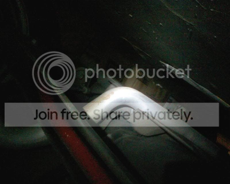

crush bend is when they crush the pipes to make bends on certain areas.. like... we need for y pipe to mufflers and so on..

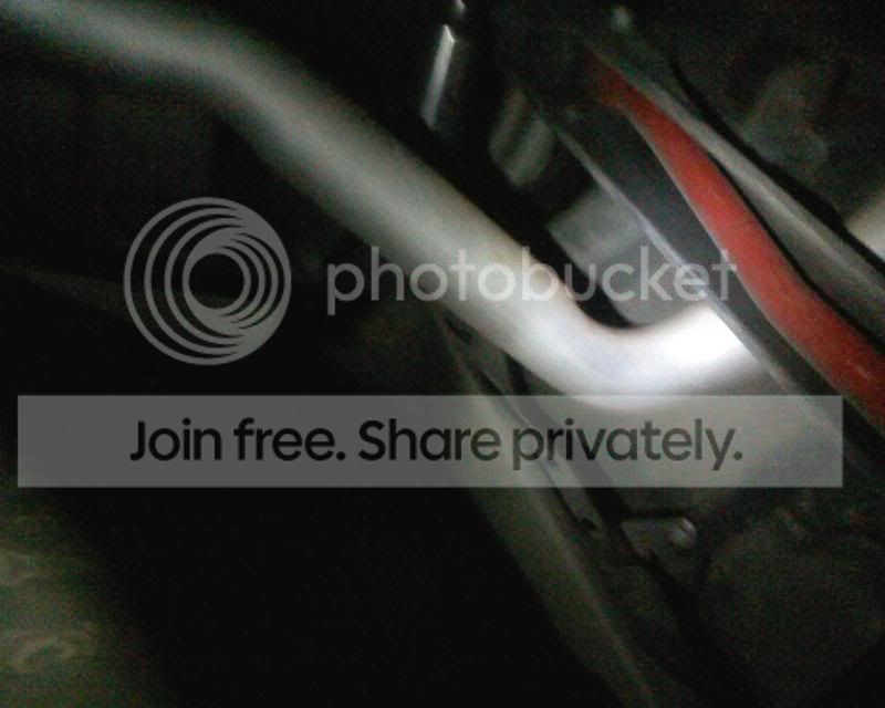

mandrel bend is like.. touching a baby's ass...
smooth..
smooth = smoother flow out.
you can see where the bends are smooth..

you can see where the crush bend is..
its like.. indented into the pipe..

making mandrel bend
http://www.youtube.com/watch?v=v98jtIja3U0

another example of crush.
