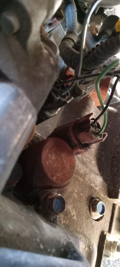

From the exploded view of trani there are 2 B an 2A solenoids.
This forward one on top
This forward one on top is a B
This bottom one under starter.
This bottom one under starter is a B. Is this right?
I serviced both and checked operation seems good but..has made no difference.
maby the connectors? I can probably make new wires to directly plug into solenoids.
Any help is greatly appreciated!

I just downloaded the service manual again. From that , it says the solenoids under the starter are a and c.

Low voltage
I wasn't getting bat voltage to ssB.
rechecked connections at PCM . Then back to basics..bad ground. Rewired new ground and direct connection to solenoid. The go cart is back smooth and strong at199k. Doing a 3&3 , fluid was nice and red. Already changed filter with last 3&3 after brake in period. What a pain in the backside but maby will last for a while. Lol
