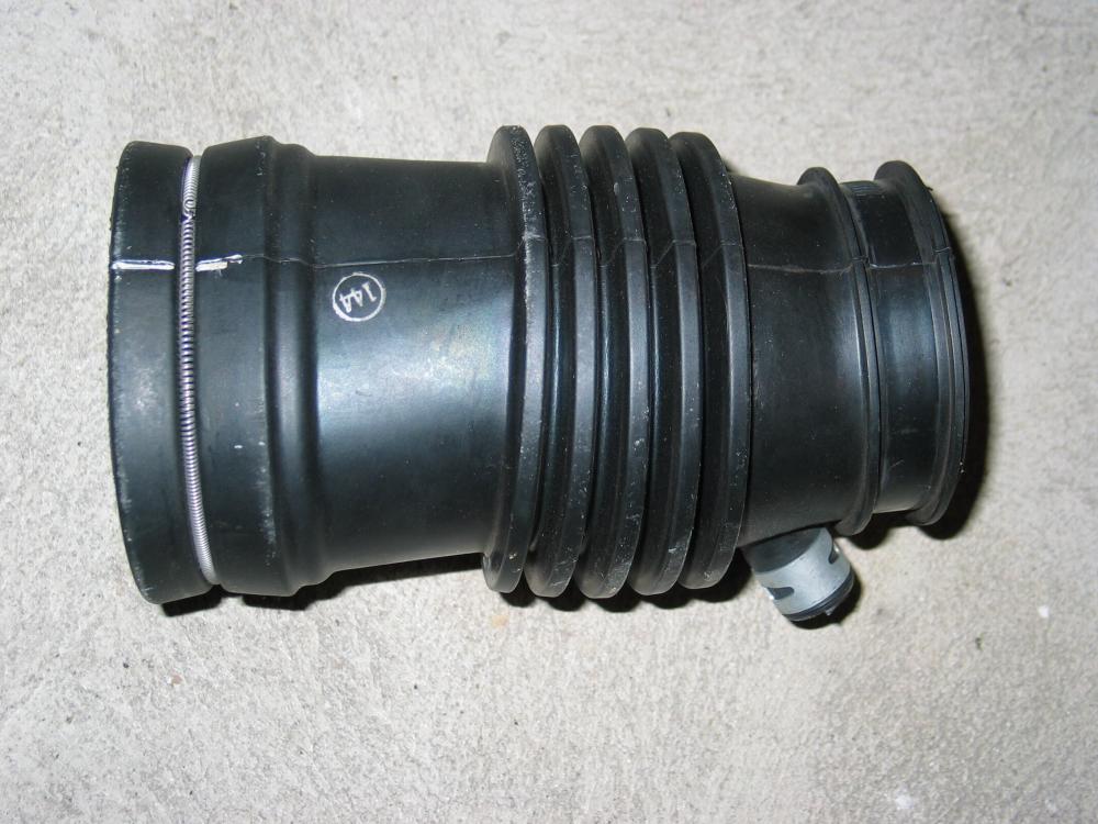

OK so I resolved the issue about connecting the breather hoses.
This is part of the stock airbox from a 2003 CL TypeS 6-speed (Thanks Shawn S)
Other nice thing is it'll reduce the amount of tubing I have to purchase.
All I figure I need is a 90 degree piece and a 45 for the bend where it goes down under the engine.
Probably gonna order everything this weekend.
I also think I'm gonna order this piece (part #8). It fits inside the hole in the sheetmetal where the intake goes through.
Hopefully it'll hold it in there tight.

part 8 would not be pactical, it is a hard plastic coupling that connects the stock air box to the stock air resinator, it wouldn't be a universal fit, nor would it act any better that a large rubber coupling. Plus a coupling would be cheaper aswell

The end of the tube looks like its Oval. will you be able to make it round enough to seal?
I didn't realize it was hard plastic. I was hoping it would hold the intake in place where it went through the sheetmetal.
No it's round.

the other end looks oval. well atleast in the pic above it does
It does go through that hole but it is not close to a tight fit nor does it mount onto the sheet metal anywhere.. It is held in place by the air filter box and the air resinator, it slides into both of them and they are mounted to teh car, so the part is "floating" .
exactly what I was about to say...that hole in between the stock airbox bottom and resonator is pretty big - that little tube piece wont support anything on its own
I realize it won't "hold it in place. I was hoping it would keep it from rattling around. Still going to fabricate a bracket that holds the tubing to the frame.
