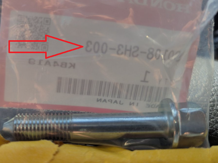

I will try and be as short as possible. I have had two rack and pinions replaced in the past year and the bushings keep deteriorating. I ordered new mounting bolts for the rack and pinions from Acura parts online, but do they take a specific washer for those mounting bolts? If anyone has any info let me know.

Which 'mounting bolts' are you talking about on the diagram below?
Use the link below to view the provided vendor picture to determine the possible answer to your question.
P.S. Gear Box - 2003 Acura TL 4 Door TYPE-S KA 5AT

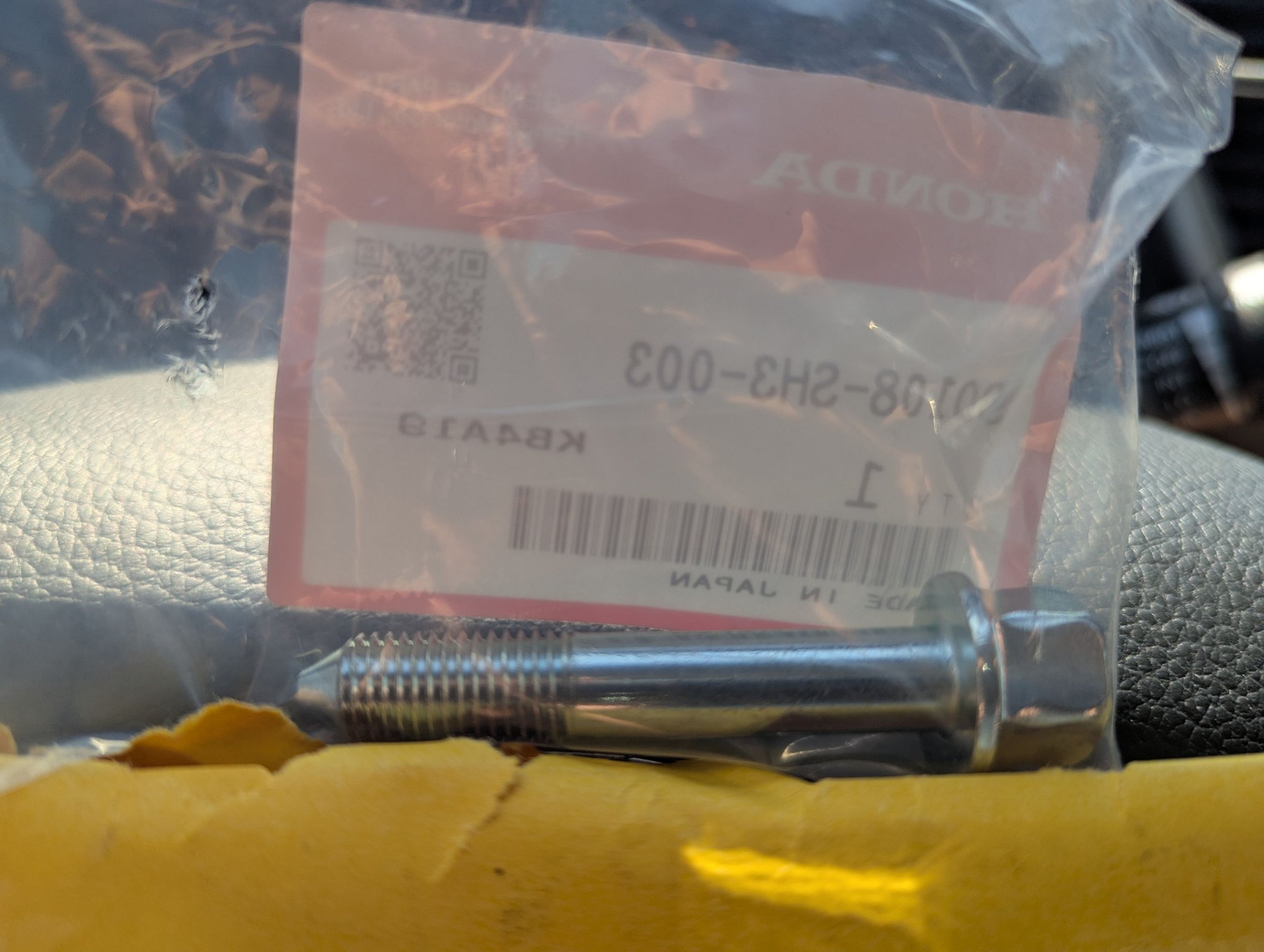

16. I ordered 2 and when delivered they didn't come with washers like shown in the picture.

No the rack comes with new bushings, 16 is the mounting bolt that the one that I received with no washer.

Interesting.
That must be an 'updated' bolt?
Hondapartsnow.com has the same picture as APW for 90108-SH3-003:
That 90108-SH3-003 part number is clearly on your picture above:
Lastly, Amayama.com has the same looking bolt on their website parts graphic:
Buy Genuine Honda 90108SH3003 (90108-SH3-003) Bolt, Gear Box Mounting (10X55). Prices, fast shipping, photos, weight - Amayama
None of which match the images used on the APW or HPN websites below.
P.S. Gear Box - 2002 Honda Accord 2 Door EX (V6) KA 4AT

Sometimes the Honda parts online stores have the wrong photos, and in this case they are showing you an eccentric bolt which is commonly used in suspension arm mounting to allow adjustment for wheel alignment. You can see the markings on the washer which delineate the range of adjustment.
If you look closely at the diagram, 16 is the bolt you received. The bolt is a flange bolt and not a bolt with a separate washer.
Do you have the metal sleeves inside the rubber bushings?

That's why I'm super confused. The shop doing the work asked me about washers and where were they, then as you saw the picture online doesn't match what I received even though the diag shows a bolt but no washer.
I did contact apw but it takes 1-2 business days to get back to me. This would be the third rack and pinion, original was bad, second the mounting bolt was wrong and replaced with another but a washer was installed. Not even a week passed and the bushings were deteriorating.
