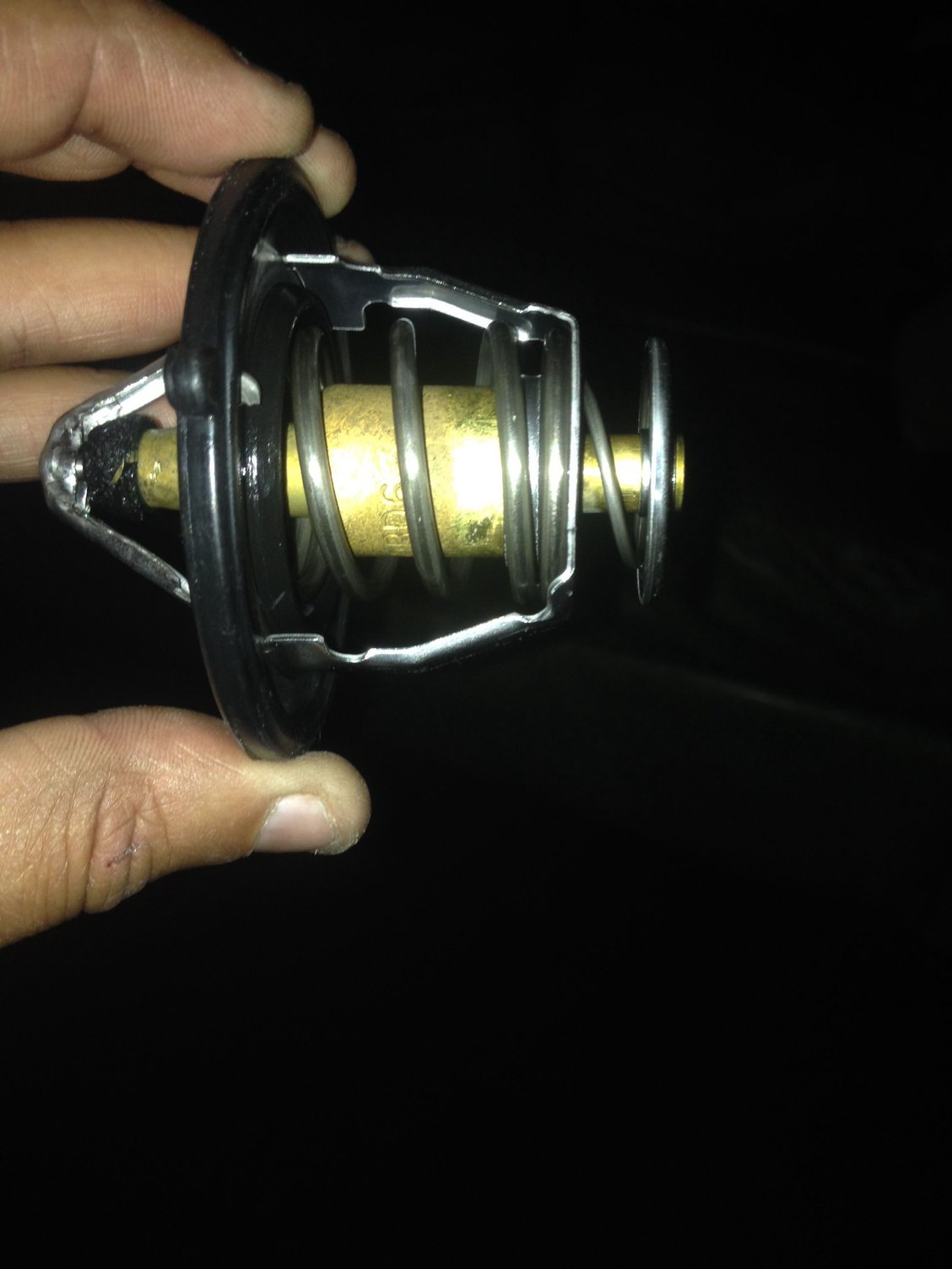

<br >When I took out the thermostat I noticed it may be opened. Is this considered opened. I know it's suppose to be fully opened to 3/8th"s or 10mm, but I don't know where to measure from. So in the manual it states that if the thermostat is opened at room temp it needs to be replaced. Any help would be greatly appricated. Thank you <br >

Old Jun 19, 2016 | 06:11 PM
Posts: 48,314
I would have bought a new one to throw in there while it was out anyway

Posts: 124
Is the thermostat opened or closed in the pic? I think it's either stuck open or closed because it only moves about a 16th. So please let me know if it the thermostat in the pic is opened it closed

musiclevelz5's Avatar
Posts: 510
Likes: 61
From: Troy, Ohio 45373
A new tstat is 20 dollars or less new. Buy a new one and put it in.
