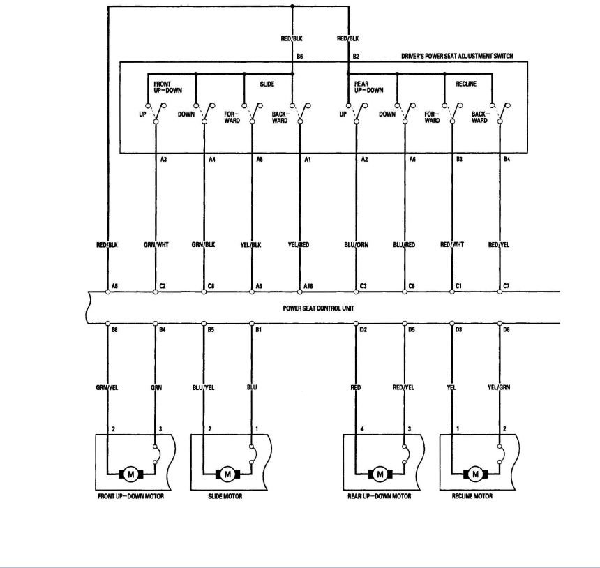

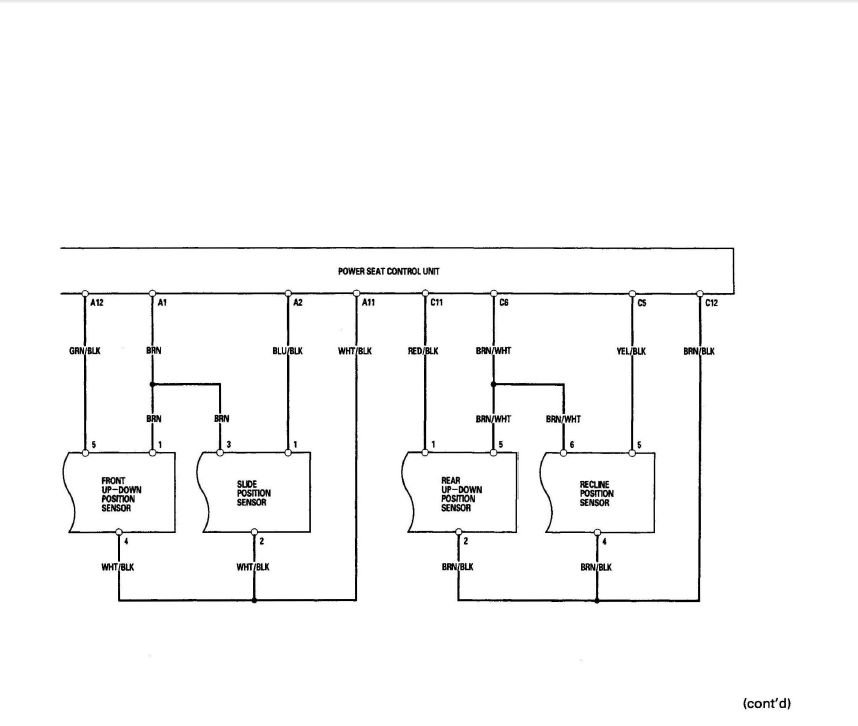

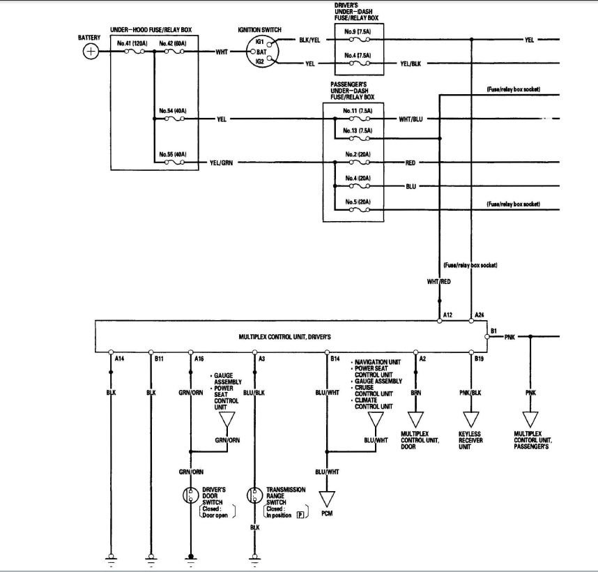

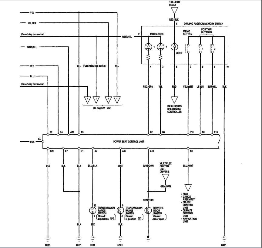

Does anyone know how to modify the electrical to allow me to use seat presets while driving?
As you know, you can't choose a seat preset when the car is in drive. I am the only one that drives my car 99% of the time. I want to use position 1 for city driving (more upright, a little closer) and position 2 for highway driving (leaned back a little, a little farther back so I can stretch my legs out.) Has anyone done this? I could probably figure it out if I had a schematic of the electrical, but I don't yet.
