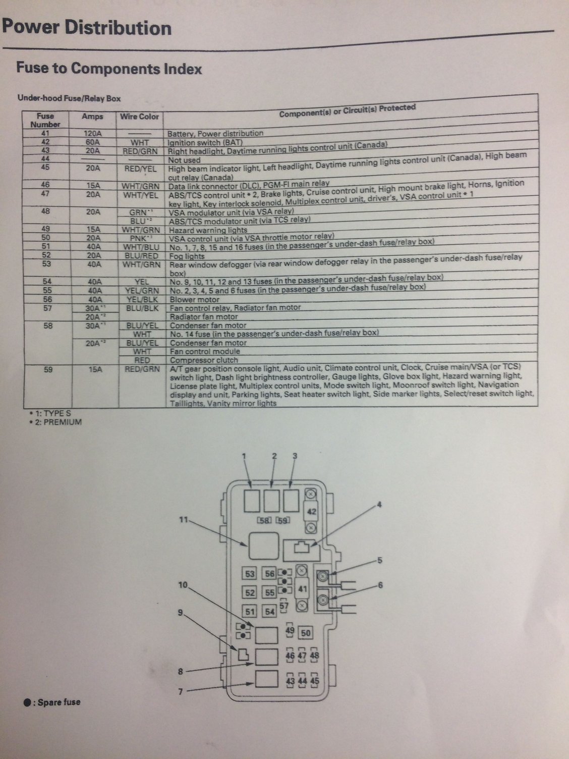

Old Nov 10, 2016 | 03:11 PM
justaparadox's Avatar
Joined: Dec 2006
Posts: 21
It's the circuit connected to fuse #59. The fuse is fine but the wiring needs looking at. It's much better to have the service manual description than the owner's manual description. Sheesh. ALL those components/circuits are out.
