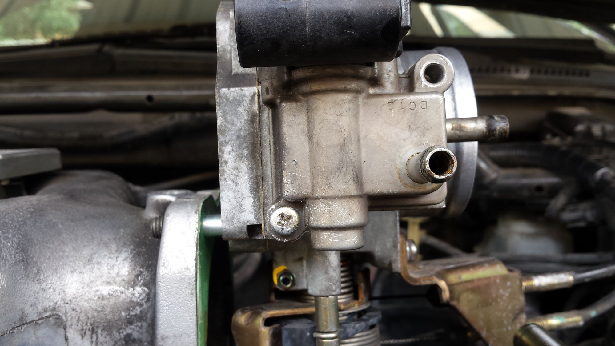

IACV screw stripped
Can anyone tell me the best way to get this stripped screw out?

Use a chisel and chisel it on the edge in the counter clockwise direction... pneumatic or hand tool.

You also use a vise grip pressure plier to get it off.

dremel cutting blade turns it into a flat blade screwdriver fitting!
Works on rear cover torx screws for headlights too

I would go down the dremel route, too. Or just anything you can do to cut a slot into it for a flat blade screwdriver.

They make screw extractors for reasons just like this: Sears.com

That does not look to badly stripped. Do you have a large phillips? Also, a trick is to use a socket phillips head so you can apply more torque while pressing down. Strips way less.
Like one of these:
Craftsman 9-42686 6 Piece 3/8-Inch Drive Screwdriver Bit Socket Set - - Amazon.com Craftsman 9-42686 6 Piece 3/8-Inch Drive Screwdriver Bit Socket Set - - Amazon.com

when in doubt whip the vice grips out
