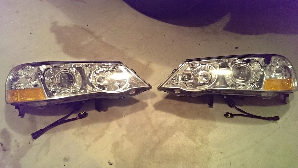

Over the past month or so, I've been working in my spare time on retrofitting HID projectors into a new set of headlights for my '03 TL-S. I decided to stick with an OEM appearance, so no cosmetic modifications were made aside from the new projectors and shrouds.
Here's a list of the major components:
  • New Honda/Stanley OEM headlights.
  • Morimoto FX-R bixenon projectors.
  • E46-R Extended shrouds
  • Philips 85122 bulbs
  • Morimoto XB35 ballasts
I'm very happy with how these lights have turned out and I am just waiting on my Xpel headlight protection kit to get here before I permanently install them on the car.
Here are some quick cell phone pics of the headlights and their output.

Awesome! What was the total cost?

Looks very good OP! Congrats! that housing is calling for a quad set up! :wink:
Should have thrown a set of mini H1's in the high beam area!

I always wondered if the guys that use a BIXENON setup actually wired the Bixenon solenoid to the high beams? So you could use 4 High Beams instead of Low Beams + High Beams.
That's how I set mine up. When I was doing all the test fitting, I didn't fire up the reflector high beams with the projector high beams, but I imagine that the combo will be nice and bright. I'll see if I can snap an output pic with the high beams on once these headlights are permanently installed on the car.

^ That would be great!! I can only imagine the great combo-wombo that would be.
I need to do this some day..
But ill go with Quad Bixenon Combo..
4 Low Beam Headlights + HID Fogs and 4 High Beams + My HID Fogs
Then go full way with Projector Fogs for the ultimate combo.
that's definitely the proper way to do it
Quad bi-xenon FTW though!

I think you need to repin the hi beam harness to get it to do quad high beams. I have quad high beams on my car.
