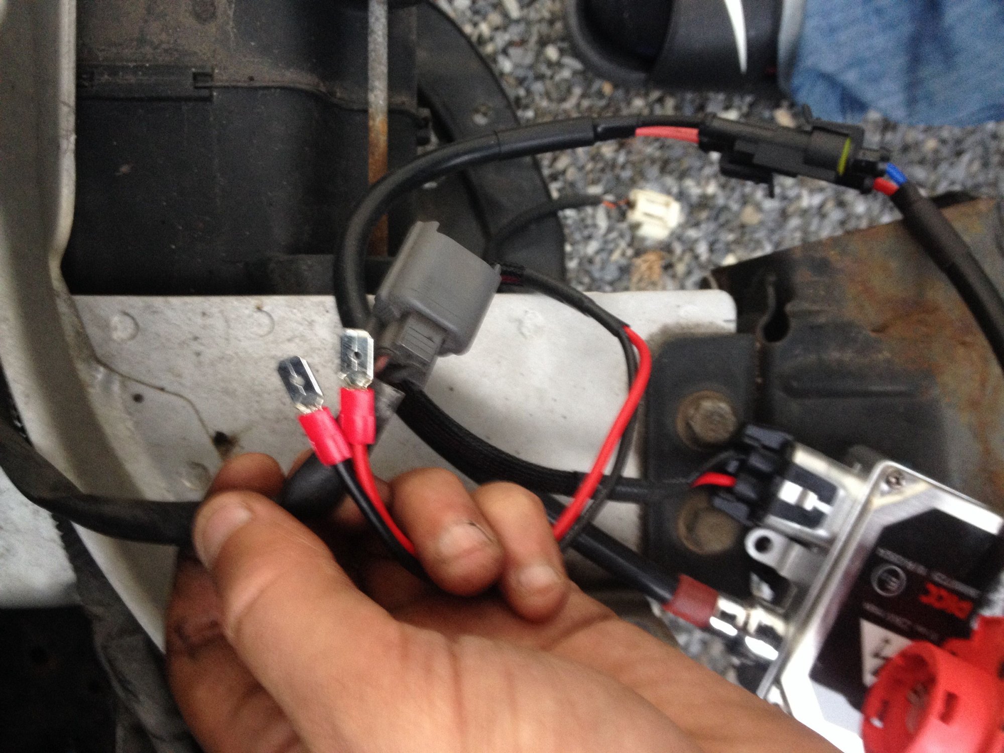

I have a 2003 acura tl and I have the bumper off and the headlight housing off already... In ready to install the new HIDS I got from HID EXTRA. I posted a pic of the wire that I think has to be cut( the gray adapter that went to the old ballast).is this correct? Also when I cut the old adapter off, is that where I run the new ballast wire and splice them in together? Also where would a good place be to mount the new ballast so I won't have to take off bumper to get to it?Any help would be greatly appricated

I ended up cutting those off and soldering them to the OE connectors and wrapping them with electrical tape. Haven't had any issues and i jus installed them a month ago and haven't had any problems since.
I've seen some people mount the new ballast where the old ballast were with some minor fabrication. Otherwise anywhere where water won't be able to reach.

you have the female spade connectors to go on the OE wire after you cut off the connector? red to red black to black, use shrink tubing to prevent water entry!!
there are a few threads in diy and main section and problems area with titles like HIDextra install- clean, or hidextra for 03
ballast on back of bumper or inside of fender- as seen in pics on those threads
Extra wire can be looped and tucked under the headlight housing as you slide it back in place
Some have even left OE ballast in place and attached the new unit right to it!

If you can wait a little bit more get this > Link > http://www.ebay.com/itm/NISSAN-Infiniti-Matsushita-OEM-ballast-to-aftermarket-wire-cable-wires-PLUGs-NEW-/331169507298?hash=item4d1b3da7e2You dont need to cut any wires its all plug and play to the OEM connector.

Thamks for all the help guys. I finally got err done... I got both lights on and now all I need to do is wets and the headlights and replace the fog lights. What is the stock bulb for the foglight and what are good replacement foglights where I can just plug them in? Thanks again guys, wouldn't be able to do this without you guys
