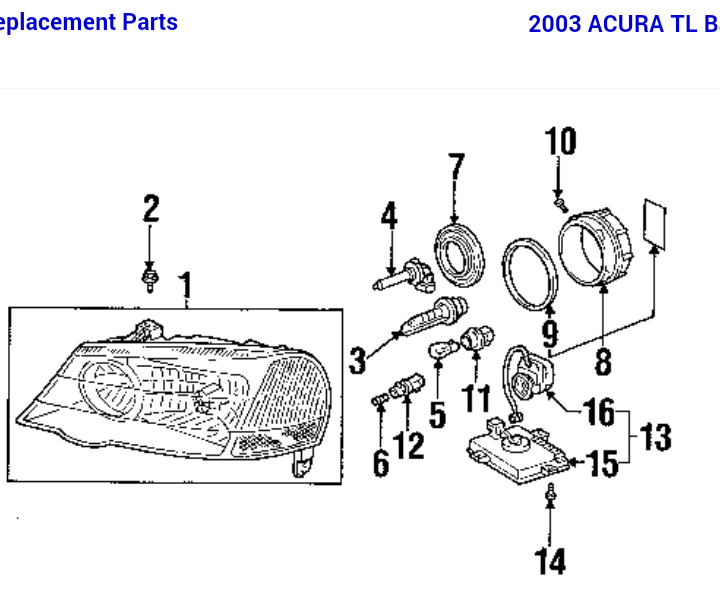

There is no ballast cord on these OEM Mitsubishi ballasts with the exception of the connection between the ballast and the bulb. The power supply connector is integrated into the ballast case, so there is nothing that you can cut off and reuse.
If the HID Extra ballasts have 9006 connectors, you can buy these pigtails to avoid having to cut off the OEM plug on the car side:
OE Ballast > 9006 Adapters
Otherwise, you can just go to Home Depot or any other home center / hardware store to get generic connectors and electrical tape / shrink wrap.

Thanks for the link... Just so I am understanding this completely...
1. There is no cord coming from old ballast to power supply connector. It is directly connected.
2. If I get this "pigtails", I will cut off the end that doesn't fit and do my splicing there (HID Ballasts have blades for easy splicing... no connectors). Once spliced and properly connected, it will connect right into Power Supply.
3. Doing it this way would prevent me from having to remove the bumper, as I don't care if old ballast remains where it sits as long as I mount new ballast to frame rather than under housing.
Do I have this down?
