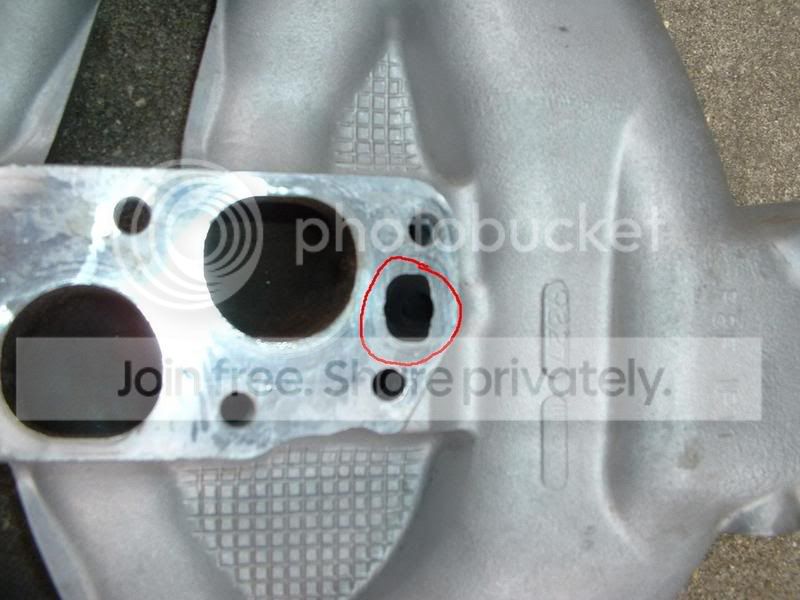

check EGR port... you'd probably have to clean those suckers out.
blue dot
and if you have a 99...
underside of the intake manifold.

Thank you so much jjashaa. Will I be able to see if the EGR port is gummed up? One more question, when the EGR valve was replaced was this port cleaned up? I even noticed a sort of a "rotten egg" smell coming from the exhaust.

^ well, i just guessed from your decription.....
when they replace, i doubt they clean it too..
clean it.... and then while you're at auto store to pick up the liquid stuff, ask them to read your code
