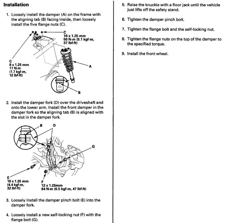

Ok. I am attaching the service manual page for the instructions on how this is supposed to be done. If your shop didn't allow the weight of the car to be placed on the shock BEFORE torqueing them down they did it wrong. The same goes for the ball joints. By having the car on a floor jack stand the weight of the front end is put on the jack stand once you put a jack under the knuckle and lift the car, the car's weight is now on the shock and the bolts can be tightened if they just put the car on a lift and replaced the shock they could never preload (transfer the weight to shock) the shock and you can torque it to specs but once the car is lowered the weight of the car will cause the bolts to be loose an no longer meeting the torque spec. I recommend you print the instructions and take it in and tell them to do it correctly, that is if there is any threads left on the shock bolt.

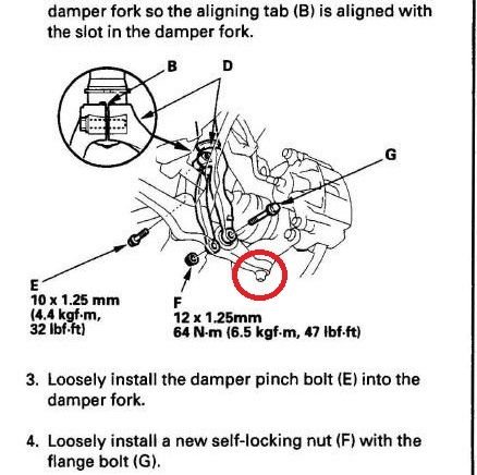

thank you very much! so it's okay to lift the car right at the knuckle? Is this a good lift point for the jack?
just trying to be extra careful. Also will the wheel need to be entirely off the ground, or maybe just lifted a couple inches?

Yes it is fine to lift the car under the knuckle. You do want to break loose the tire lug nuts first, then lift the car, place jack stand under the car, remove the tirel, then proceed. You can use the normal lift points to place the jack stand.
You want to lift the car and put it on a jack stand for safety. You should remove the tire, once the tire is off you can put the jack under the wheel knuckle and jack it up so that it is off the jack stand, When the car is a inch higher than the jack stand it is fine, then work the lower and upper bolts. In YOUR case since they are tightened you will need to loosen the bolts shown, you do not need to remove them just make then loose. Then raise the car off the jack stand and then tighten all the bolts, honestly I have the torque tools but on these areas I use a impact wrench and make it tight.
