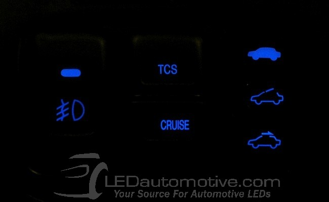

There's a thread on here about replacing them, theyre not expensive but IMO i'd get an LED kit or at least the one bulb from somone like....
LEDautomotive.com
Just click on " Car Specific LED Kits" they're pretty darn cheap and i've personally bought from this guy so I can vouch for their quality. 5-7 bucks may be more than the standard bulbs but $7 for one you dont even have to solder sounds good to me. He even has installation guides for the 2 Gen TL if you choose the cheaper $4 one that has to be soldered. I plan on converting my entire interior to blue, already got the doors and dome/map and center console lights done...... My stock NAVI buttons are the only ones i'm worried about....

Old Feb 11, 2015 | 04:00 PM

Thanks guys! Looks great in blue d4atls!
