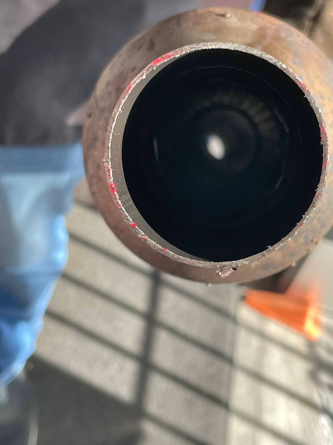

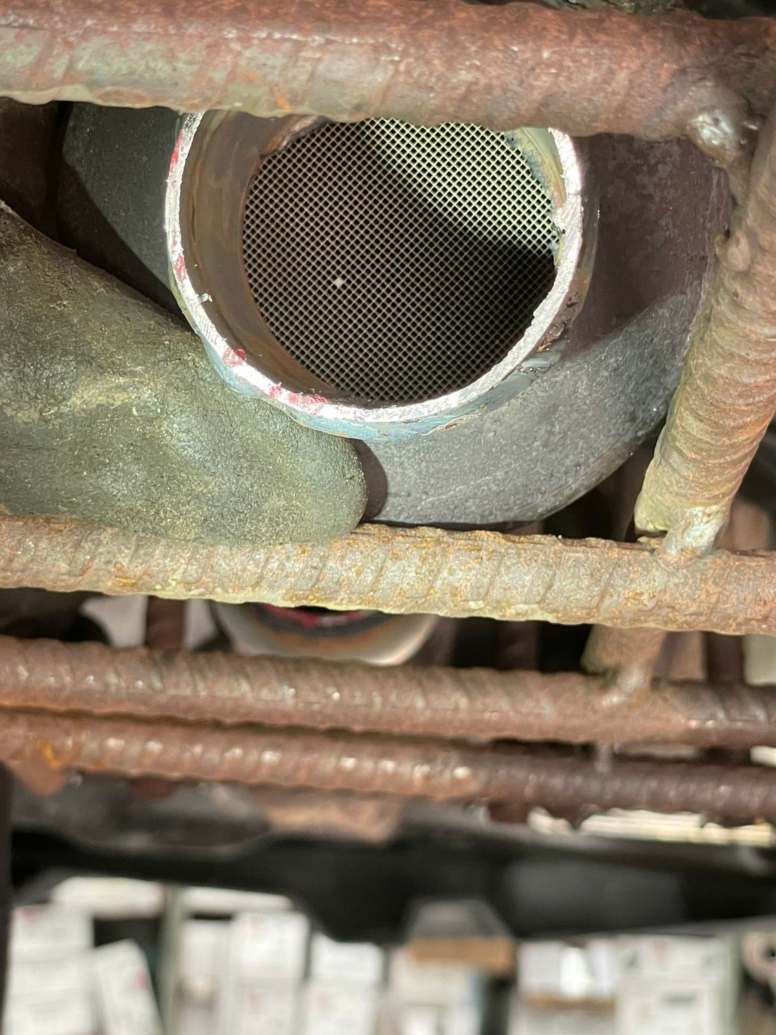

8. Muffler shop have given up. Muffler shop suspected i was using bad sub standed and caused the catalytic converter to melt. I use Costco gas. They unweld the catalytic coverter piping and it was fine. Pics included..

is that a rebar chastity belt for you cat?
I'm not entirely certain, but you probably need a catalytic converter that is specific to your models emission group.
