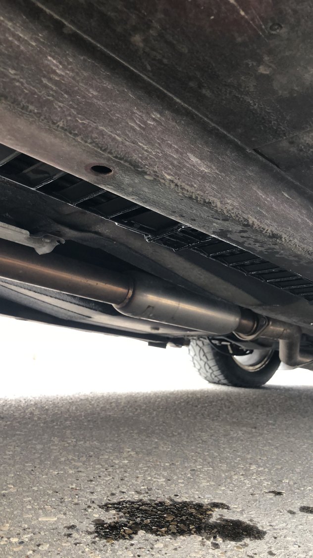

Hi all, I have a 2003 Acura TL. I was driving home the other day and noticed I had to press really hard on the brakes to stop the car. So I got home and checked the car out and noticed there wasn’t much pressure I the brakes. So I looked into the resistor of the master cylinder and it was empty. I found the leak On drivers side rear right where it goes up by the fuel tank. The leak is on the long horizontal line that goes from front to rear. I can’t get the black cover off. Anyone know how to get off? I was ready to rip the dam thing off.

That first pic looks like those 2 tabs are holding it in on that end and you should be able to depress release and it would pop off. Not sure how other end is affixed
