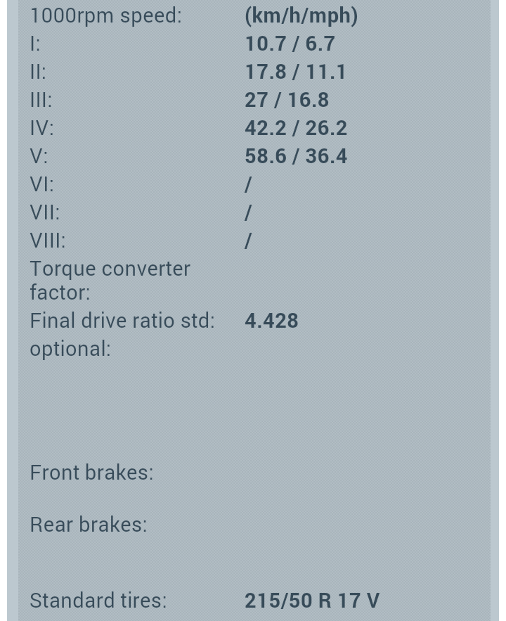

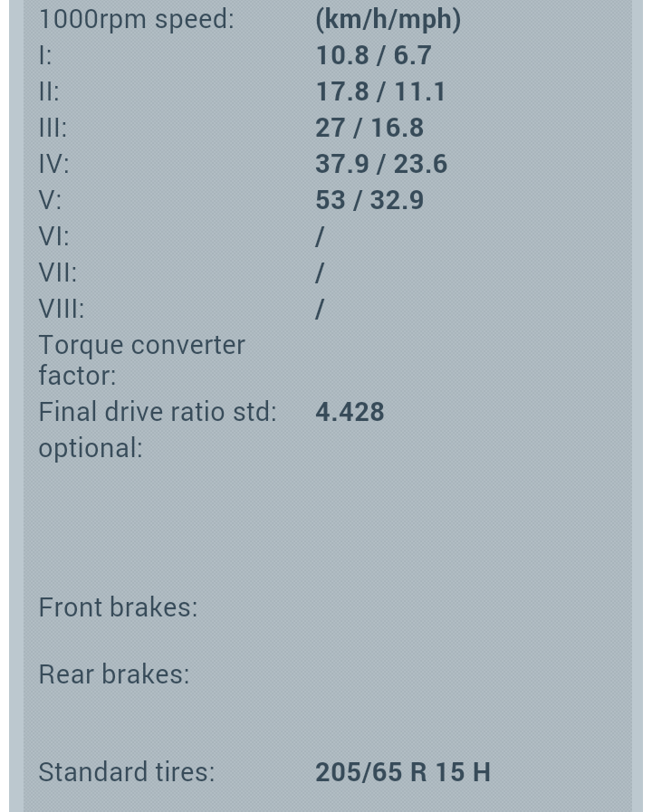

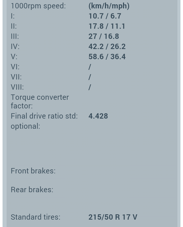

As requested.
2006 Honda V6
2000 TL P
2002 TL S
2001CL S

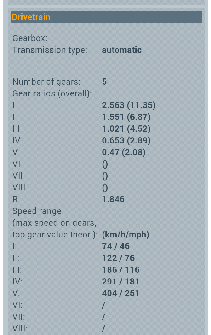

Old May 1, 2015 | 09:53 AM

^ The TL-P and TL-S transmissions do not have the same 4th and 5th gear ratios. The below is taken directly from the shop manual:
TL-P
4th - 0.653
5th - 0.470
TL-S
4th - 0.727
5th - 0.520
The AV6 trans has the same gear ratios as the TL-S trans.

Those charts are wrong 01acls, Look at the Maintenance Manual.

You are correct. I've checked with my manual too.
So disregard the TL/CL Type S above. So sorry.
