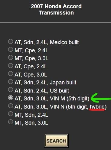

This is the transmission I've found, but I don't know if the VIN M 5th digit is an issue in terms of compatibility and I can't find any information regarding.

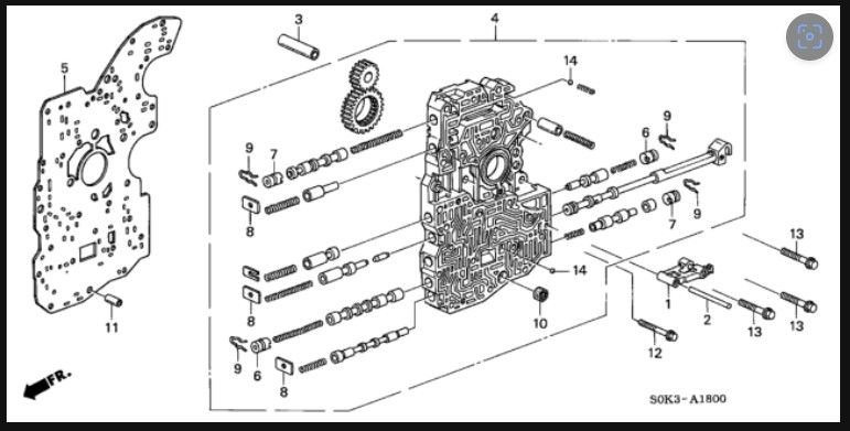

I was also poking around looking for a replacement torque converter for it, in case the one in the new trans is shot, and happened across this lube correction kit, was wondering if using this was required, recommended, user preference, or not recommended.
You have the correct 'VIN M 5th digit' search criteria (green below)
It's the 'VIN N 5 digit, hybrid' you do not want (red).
Outstanding, thank you. Any idea on the lube correction kit? Largely irrelevant, I take it, as I haven't seen mention in any of the other posts I've been checking, but figured I'd verify.
Though not positive, it appears to be irrelevant to your cause.
It would only be relevant if you were rebuilding since those components appear internal to the trans?
27000-P7W-020
