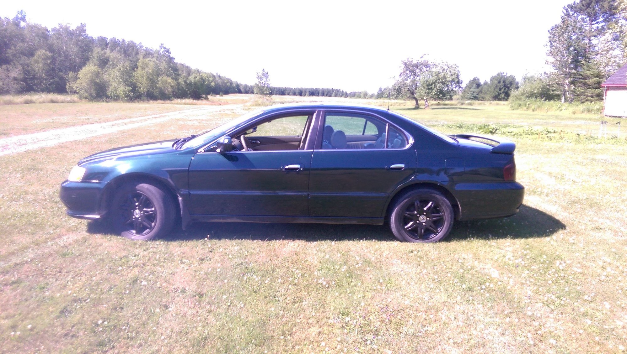

Hey, ive got an '99 acura tl with a j32a1 automatic transmision the car is full stock and i want to swap it with an bigger engine and an 5 or 6 speed standart trany. The car have at lease 250k on the engine and the frame. When i bought it the trany was allredy slipping and now its sliping evry 4 gear so that is the reson why i want to swap it.
i want to know what are the posibilities of engine and trany for this swap and things i need to know before starting buying parts
tanks for reading!
