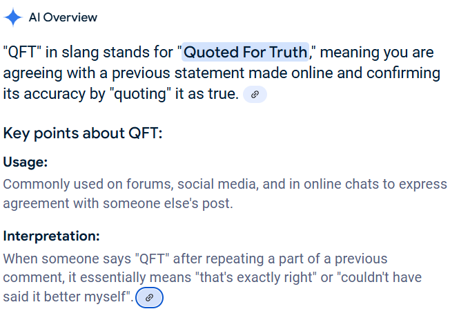

qft
What is QFT? I'm not good with acronyms lol
Old Feb 24, 2025 | 01:17 PM
Posts: 48,314
https://letmegooglethat.com/?q=what+is+qft
Old Feb 24, 2025 | 03:48 PM
Posts: 6,926
Likes: 2,215
@thoiboi when I clicked your link above it came up with:
@xjokerz :
Old Feb 24, 2025 | 04:20 PM
Posts: 48,314
no, i was definitely referring to quantum field theory and its application in designing the original transmissions on this generation of cars hence why it's such a nightmare to try and troubleshoot
