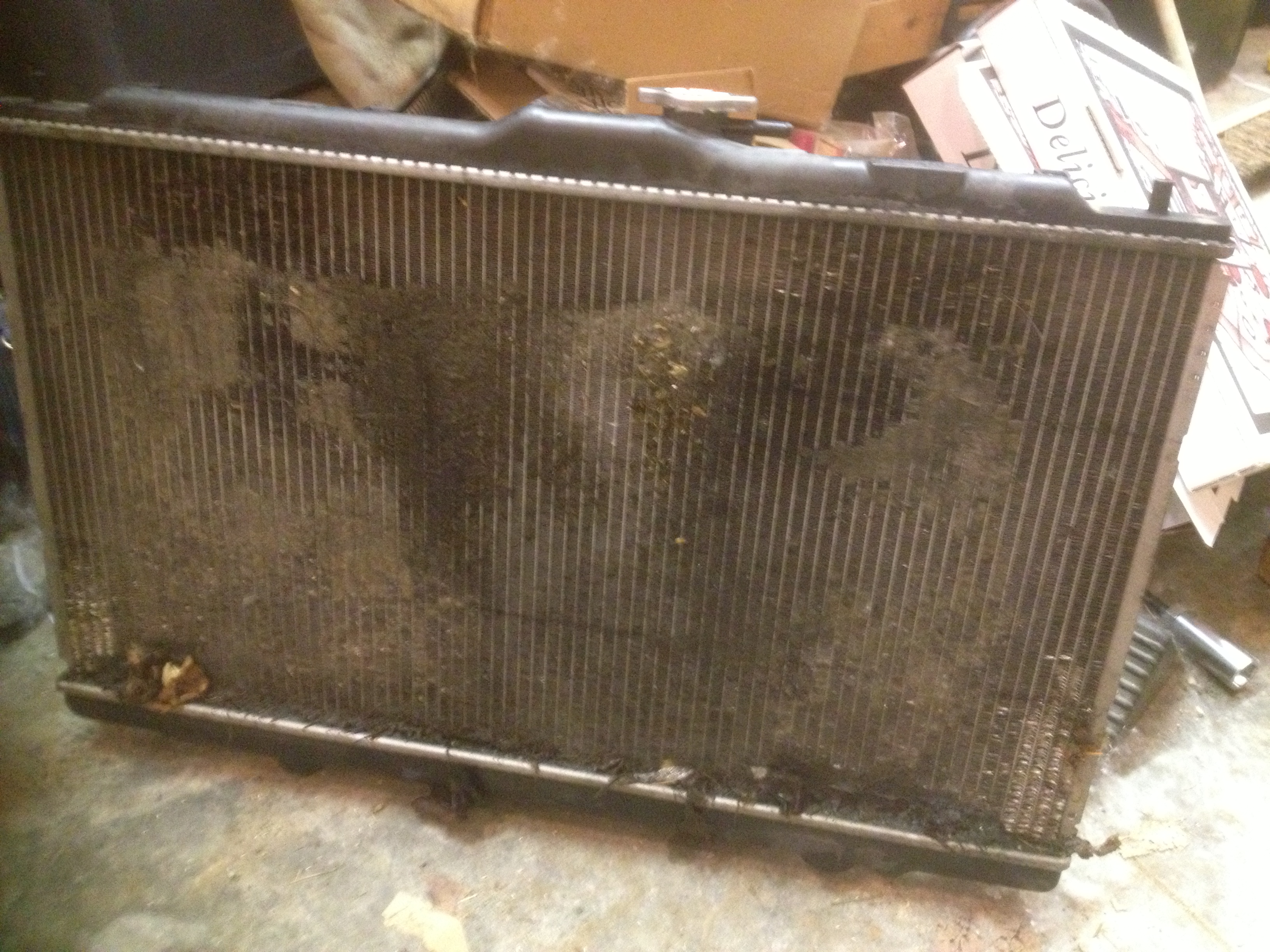

Old Jul 12, 2016 | 06:58 PM
jpelizza's Avatar
Joined: May 2012
Posts: 56
The culprit was bad radiator. I didn't realize I was looking at condensor from front side of car, when I took radiator off it was CLEAR that it was all crudded up with stuff. Replaced radiator and no problems at all!
Old Jul 12, 2016 | 07:00 PM
jpelizza's Avatar
Joined: May 2012
Posts: 56
Pic of radiator
Here is pic of radiator!
Attached Thumbnails 2000 TL over heating with a/c on-image.jpeg
