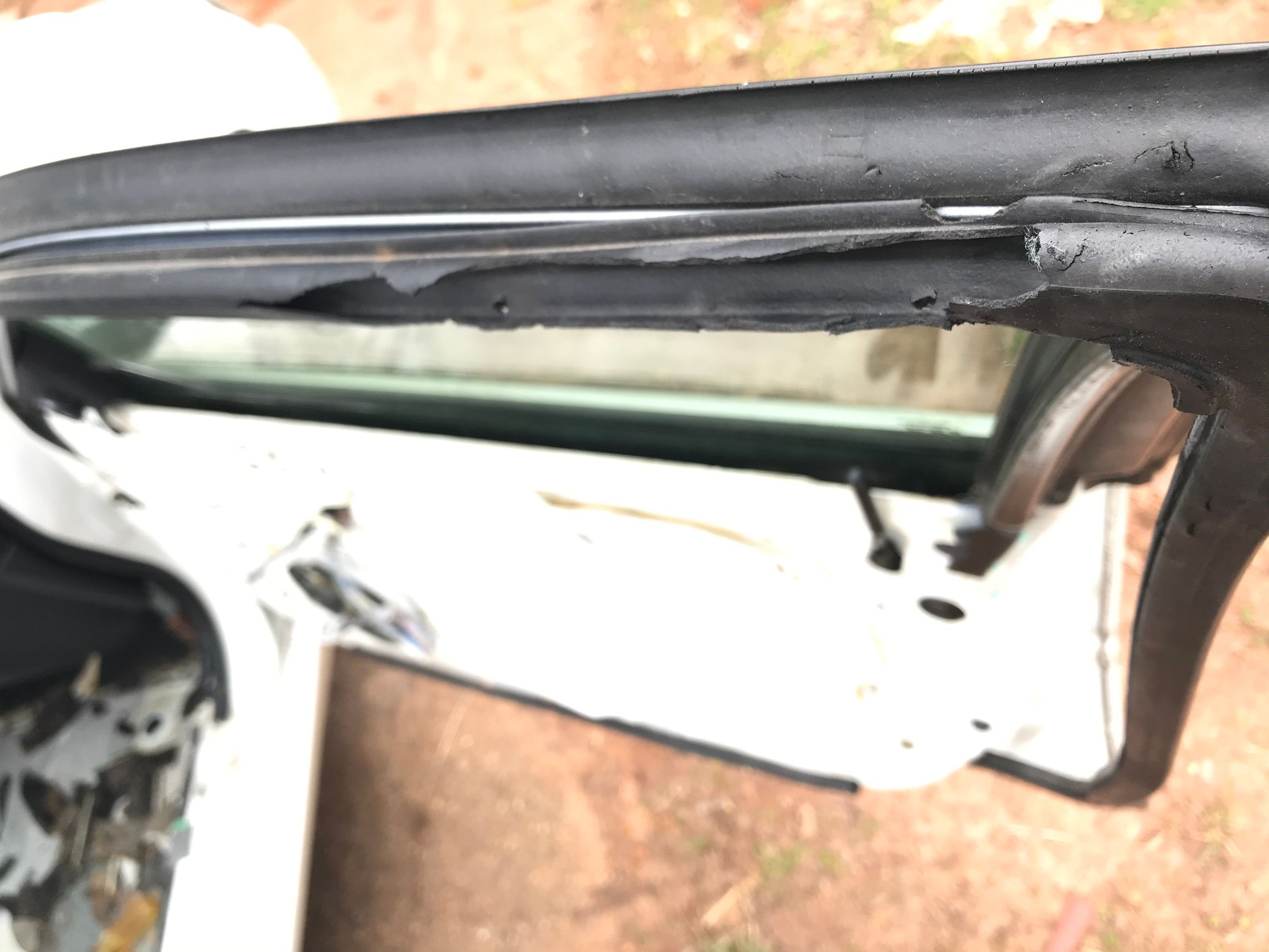

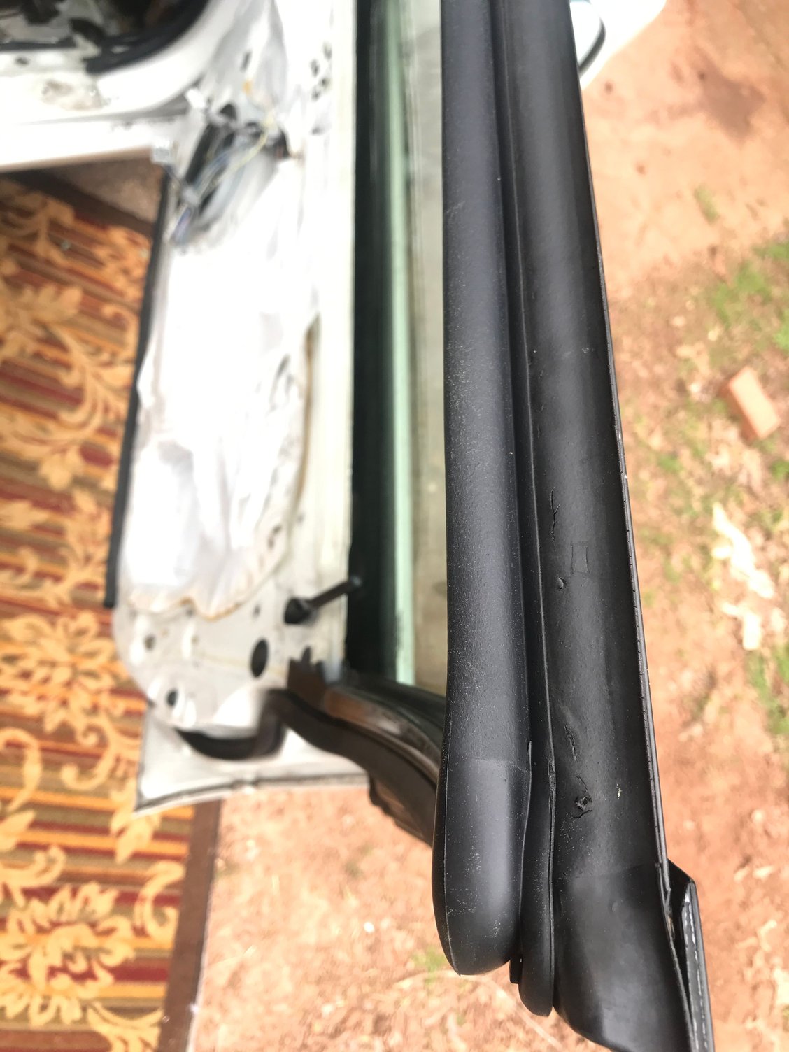

Got a new oem R F door gasket for $40 put in today.
It was a perfect fit with new clips already installed. Always go oem with gaskets and weatherstripping!

geezus! how did it get so torn up!?
I replaced all four of mine because although they looked fine, I suspected that I had become complacent with the wind noise there were allowing into the car; I was right! the doors require a little more umph to close and the ride is much quieter.
btw...I believe the rear drivers side is no longer available, if you're interested in replacing the others I would suggest to do it soon and search ebay for those discontinued; you might be able to find one.

look at the chrome trim above the door.. I’m guessing someone habitually locked their keys in the car, and that was where they jimmied the door open over and over again!

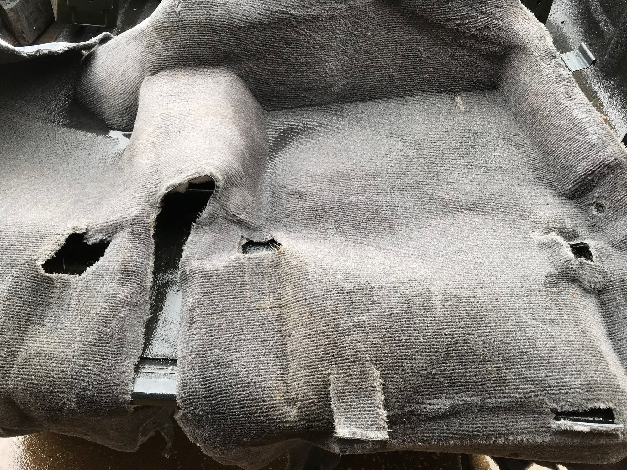

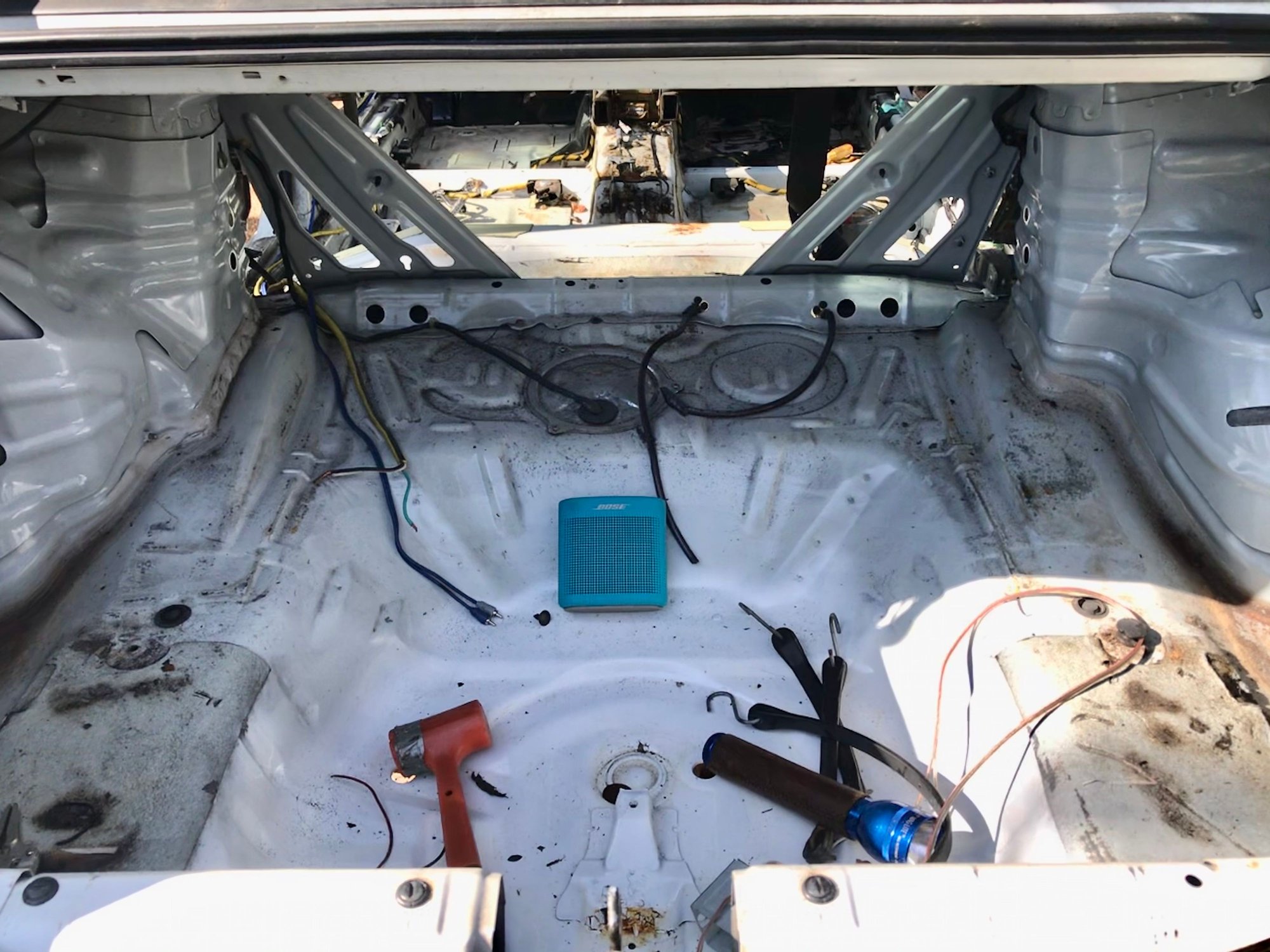

So I think in my op I said the carpet was soaking wet because of the shredded weatherstripping..
Currently, The entire interior, excluding the dashboard, has need removed, cleaned thoroughly, and is now being dried out in a guest bedroom. I am using an air mover to focus dry all the individual parts, then I’ve got a dehumidifier running continuously on high to really dry things out!! It is working like a charm. The carpet actually feels crispy to the touch it so dry!!
Note the Bose Speaker mod^^^
Overall not bad under the carpet!
The soundproofing material on the passenger side is brittle and busted, that’s ok I’m going to remove it and put down a double layer of Noico 80mm sound deadening material.
I did that to my Tacoma a few years ago and now you can hear a pin drop at 80mph
Next step after drying everything out is to wipe clean every square inch of exposed metal before reinstalling the interior.. I have a BIG can of industrial degreaser and cleaning wipes just for the job!

Before removing and cleaning I wasn’t sure the carpet was salvageable...
After 2 cans of Pro Carpet cleaner/ spot remover, lots off deep scrubbing, and about $10 at the car wash using “Rinse” at the pressure washer, it looks WAY better!!!
