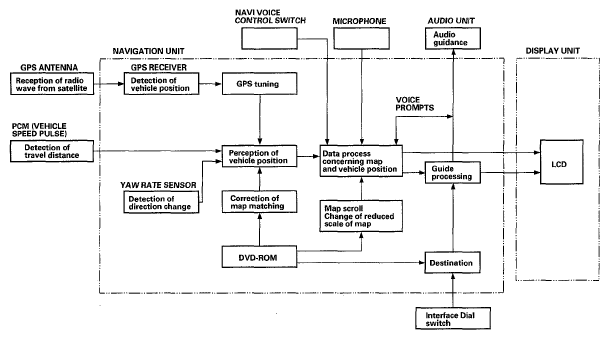

Old Aug 27, 2014 | 12:40 PM
M T L T L's Avatar
Joined: May 2009
Posts: 704
Likes: 53
From: MTL
I'm no expert in this but if the 20 pin wired connection (Connector A in the diagram) from the Nav unit in the trunk connects directly to the 20 pin harness behind the display unit, I don't see why it shouldn't work.
The 3rd diagram is of the audio system. The audio unit Connector C 14pin is where you will connect the grom unit.
Here's the diagrams.
