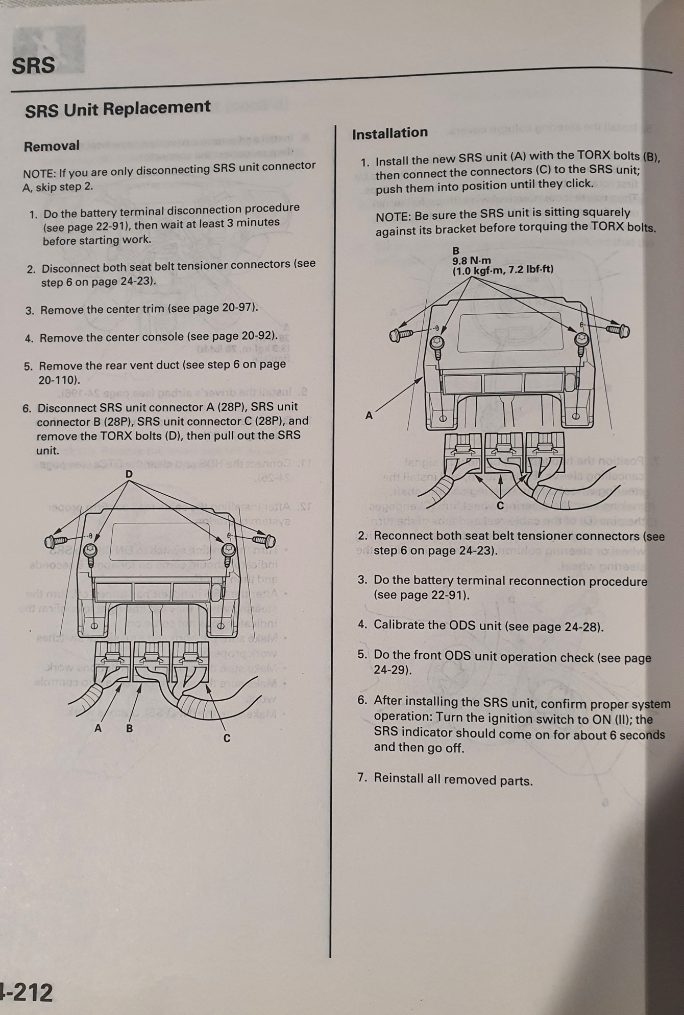

Looks like I'd need pages 20-92 and 20-97 and 20-110, please...

Here you go

Old Jun 8, 2024 | 03:59 AM
Blues Legend's Avatar
Joined: Jul 2013
Posts: 352
Likes: 50
From: Hertford UK
Many thanks for that, Nomgle!
Phew...it's probably merely the side panels that I will need to remove (and the not an ashtray) if the videos of AccordTLXs are anything to go by.
