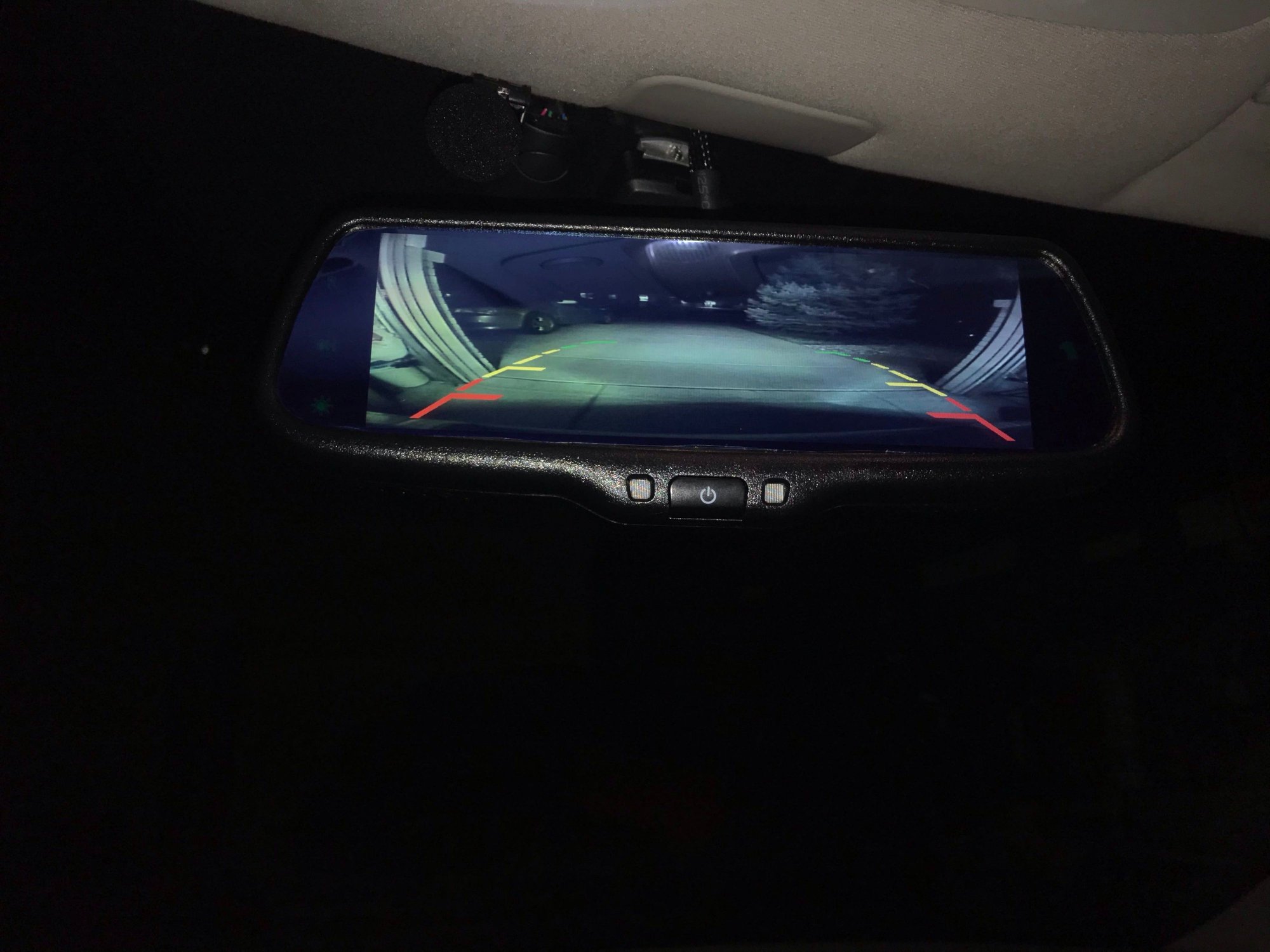

I do have that in my 08 RL. I have the basic RL which doesn't come with camera. So the camera is aftermarket as is the rear view mirror.
Camera automatically invoked when in Reverse
It has the guidelines and decent night vision.
But I didn't install it myself, I had BestBuy install it for me. It is much better/brighter than the factory option using the navi screen.

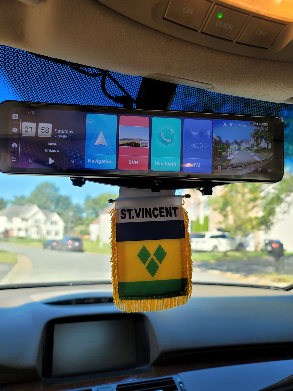

Cool, thanks. Mine has Android and accident avoidance/lane change warning built in. I can run Waze and other apps on it and record front and back video at the same time, etc. Looking forward to getting this installed. How much did Best Buy charge you?

Just an update.
Waze
Will post a pic of the full rearview and the split cam view.
Ran the cables myself. Was a lot easier than I expected; a plastic pry tool made it a breeze.
