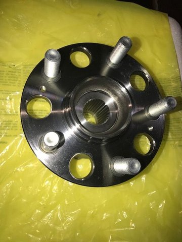

I ordered the Timken for the left rear. Arrived last night. Now just waiting for a new torque wrench that can go up to 220ft-lbs. Hopefully my existing large breaker bar can get the spindle nut off! I'll try to crack it while the tire is still on the ground.
Here are a few pics of the Timken wheel bearing:
Closer look at the splines of the bearing assembly.
Close up the metal work of the hub.
Zoom-out pic of the assembly. Left rear.

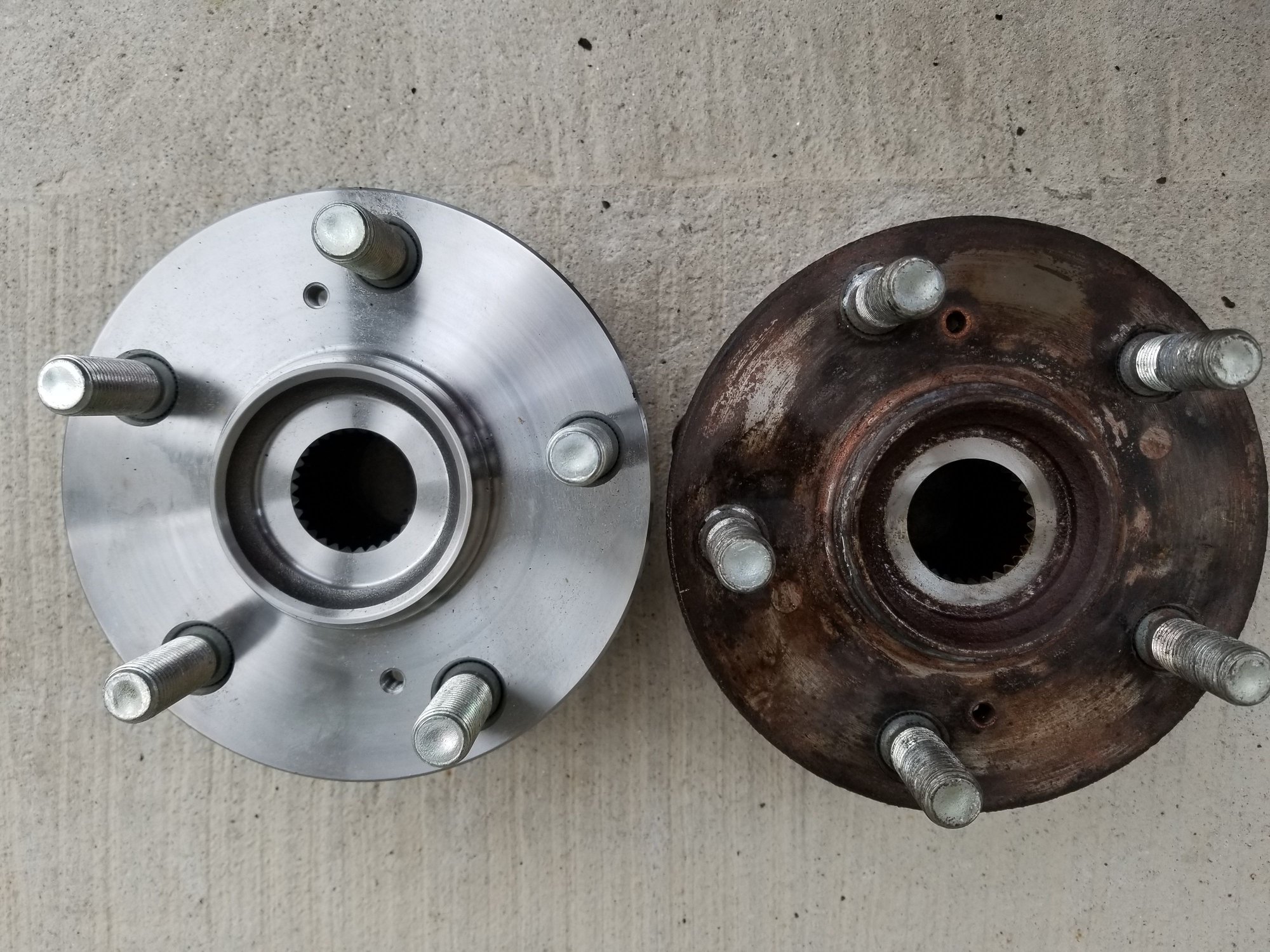

Got the front wheel bearings installed today in addition to new OEM shocks, front brakes, and spark plugs. As mentioned above, for wheel bearings, we used the air impact gun.
The car drives really nice. I definifely can tell it is more responsive in turns. The shock absorbers makes the ride a lot smoother, making the ride very enjoyable on the freeway. Overall, the car drives like it did when I first test drove it, so I am in love with it again. In the process, I have found that the front compliance bushings are getting worn, and so Lower control arms will be next on the list of things to replace.
note: my original wheel bearings were fine, but I definitely can tell the car is more responsive in steering with the new Timkens wheel bearings. For reference, my car has 116k.
