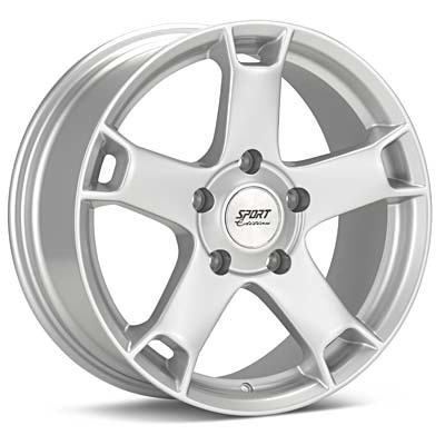

wheels - opinions
what do you all think of these...
http://www.tirerack.com/wheels/Wheel...All&sort=Brand
they are smilar to the OEM 17" wheel... in that they have large wide spokes..but with a split thing at the end.. and they are larger at 18"... weight is good. price is good.
just wondered what the consensus was on these..
i'm leaning toward sourcing a nice used set of OEM aspecs.. 18"
trying to see what kind of a deal I could get on ron jon revs in 18".
or something from tire rack...
i really like the look of 19" wheels... but don't want to spend the extra mnoey for bigger wheels and bigget tires.. the prices on 19" tires alone are quite a bit more than 18....
i tried to copy the picture that tirerack made of my car with these wheels...but it won't work.... they honestly dont' look bad on the pic that tire rack does... much better than the OEM wheels..despite the wheels being "similar"....
if you have the time, pull up the wheels on tire rack and then configure them onto an RL and see what you think.

I'm not feeling those wheels. They look bulky. I like the revs or black chrome Aspecs much better.
