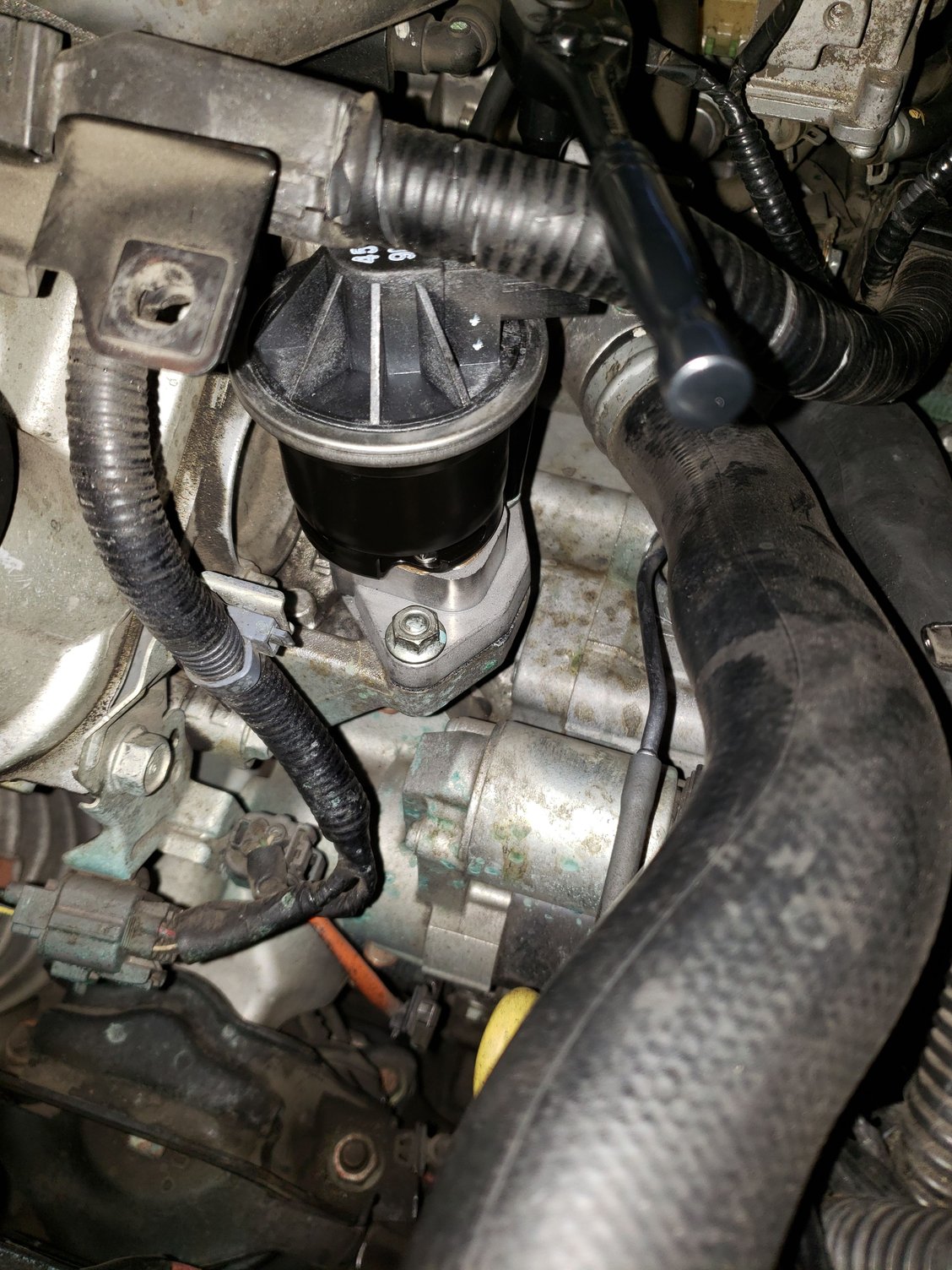

yup, i am cleaning the EGR right now. a lot of carbon. going to put it all back later today or tomorrow and put in BG 44k fuel cleaner and see how it goes. if it isn't the spark, it must be fuel or leak. i hate misfires lol.

well folks..I may have fixed it but hoping it will be permanent. I cleaned EGR valve and ports with throttle body fluid. used my shopvac to blow the carbon out. I also cleaned the MAS sensor. Replaced all spark plugs even though they were replaced only 15k miles ago. I noticed they were loose. so, i tighten it down till it is snug but definitely a little over 22 ft lb. Lastly, i put some BG fuel cleaner in.
No shuddering or any issues so far. Will update in a week or two.

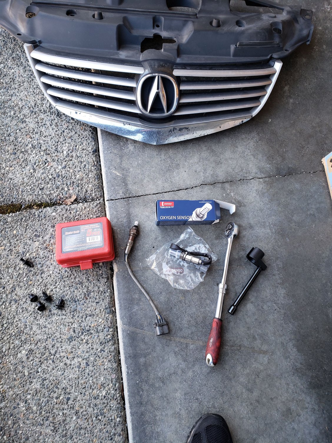

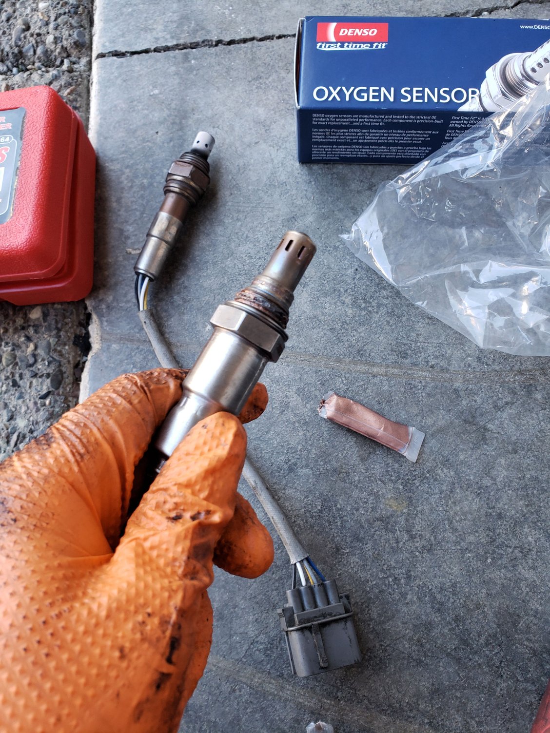

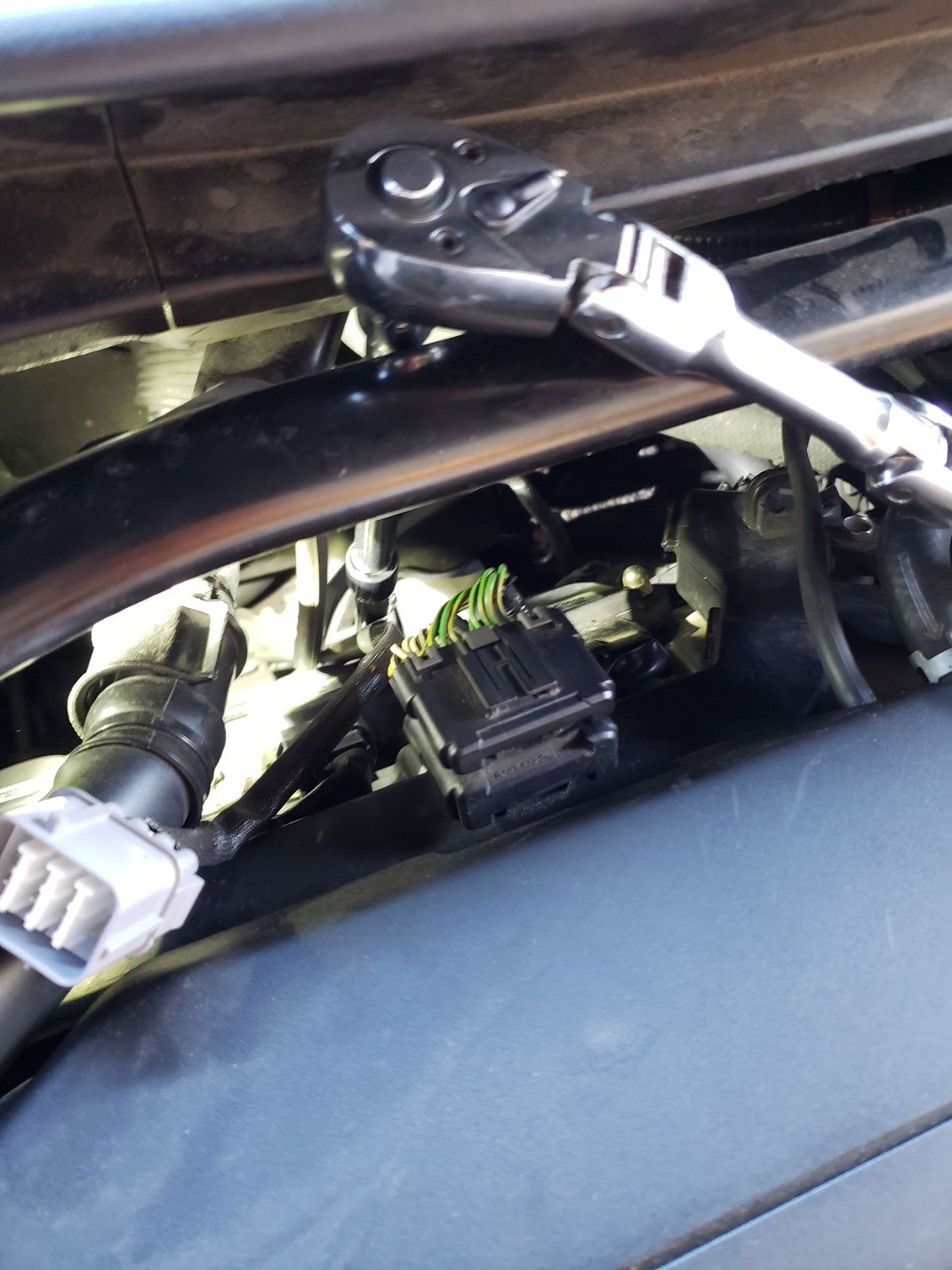

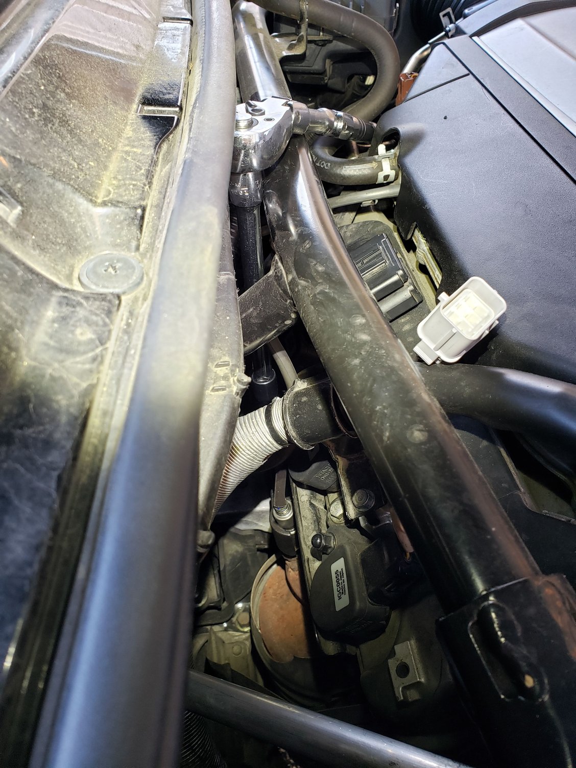

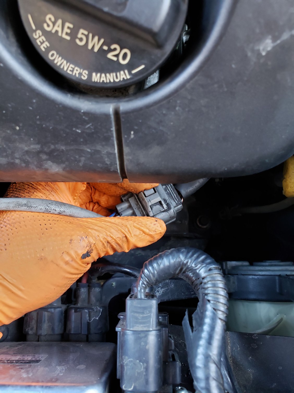

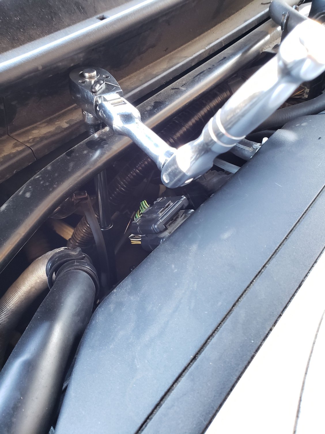

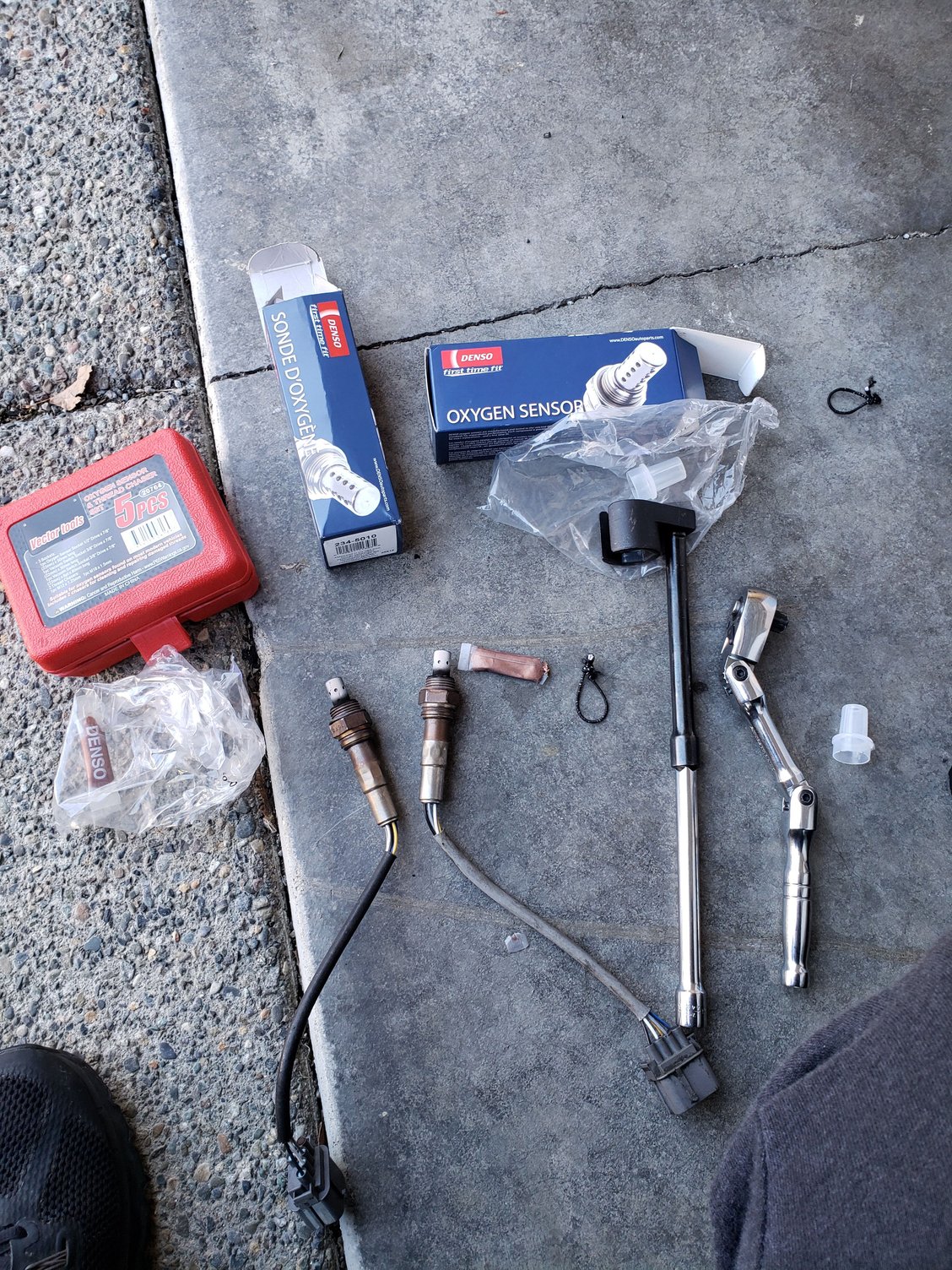

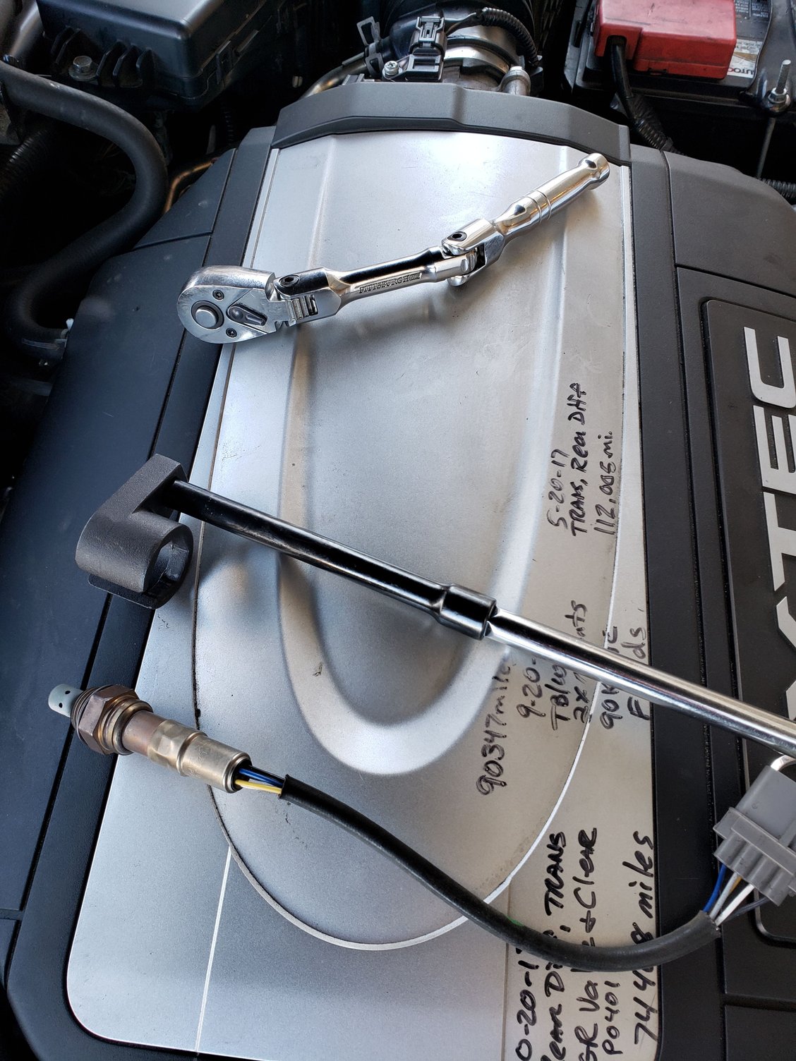

Thanks for the suggestions by members here, I finally got around to replacing my O2 sensors today. I will monitor the car for the next few months to ensure the car doesn't burn the spark plugs again due to lean condition.
The install itself is pretty easy if you have the right tools. I bought both Denso sensors on RA.
